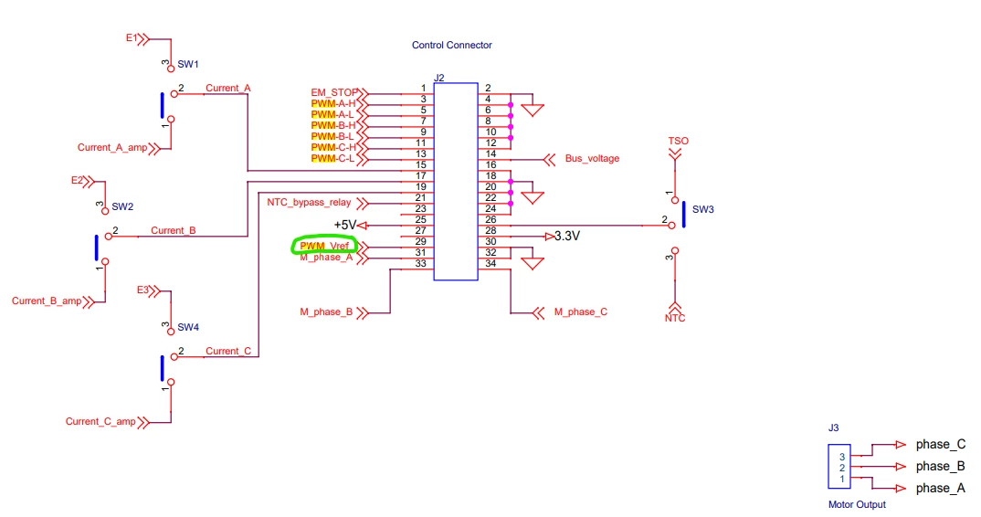

Hello again, dear STMicroelectronics team,
While reviewing the schematic sheets of the STEVAL-IPM10B Evaluation Board, I came across a connector pin labeled 'PWM_Vref' (highlighted with a green circle in the image below). However, I couldn't find this pin mentioned in any of the other schematic sheets.
I would like to ask: What is the purpose or function of this pin?
Thank you in advance for your support.

Apr 8, 2025 7:24 AM UTC
This is a remnant from the time when the 34-pin motor control connector was defined. At that time, this signal was used for special daughter boards. So you can safely ignore the signal.
Does it answer your question?
Regards
/Peter

Thank you so much again dear Peter.
