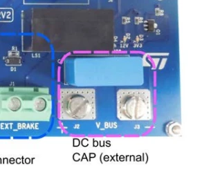

STEVAL-HKI001V2- How to connect 36V to 330V DC power supply on 3 phase AC supply
Please provide and diagram or application note on the same.
8 replies
Gigi
Nov 21, 2022 9:13 AM UTC
Ciao
I never tested it but, I think, that if you want to supply a DC voltage to the board is possible to use the same connectors where you mount the external DC Capacitors respecting the polarity.
See UM2645 for some details on the board.
