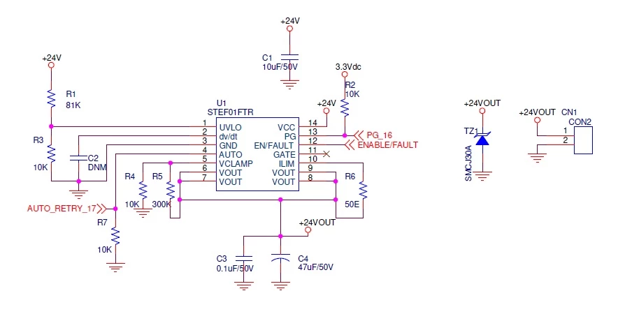

We are using STEF01 e-fuse with 24V input at VCC. See schematic below for your reference. Without any load connected at Vout pin we get around 22.73V (with Vclamp floating).
If Voltage is clamped to 28V(ie:R5 -300Kohm and R4 -10Kohm) then we are getting output around 17.55V.
But as soon as we connect any load (e.g. (0-10)Kohm resistor) at VOUT, output voltage is becoming 0V.
(Note: Exposed pad is connected to Vcc)
