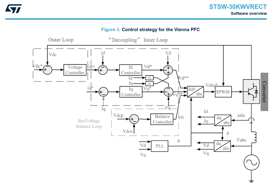

Hello all,
In the STDES-30KWVRECT Vienna Rectifier power circuit,
1. Relation between Q1 and Q2 switching pulses are IN-PHASE, likewise I want to know, How Q1 and Q3 switching pulses are related ?
2. What PWM technique is used to generate switching pulses for Vienna Rectifier  STDES-30KWVRECT ?

Unfortunately ST seems to try to hide some things. But since this project is an implementation of the "Vienna rectifier", the concepts can be found in other sources:
The Vienna Rectifier is a pulse-width modulation rectifier, invented in 1993 by Johann W. Kolar.
https://en.wikipedia.org/wiki/Vienna_rectifier
Another project that seems to have a lot more reference material is this one:
Description
The Vienna rectifier power topology is used in high-power, three-phase power factor correction applications such as offboard electric vehicle (EV) chargers and telecom rectifiers. Control design of the rectifier can be complex. This TI Design illustrates a method to control the power stage using C2000™ microcontroller (MCU). The hardware and software available with this design helps accelerate the time to market.
https://www.ti.com/tool/TIDM-1000
ST Material:
https://www.st.com/en/embedded-software/stsw-30kwvrect.html

Thanks for the reply.
But,
we need answer to the mentioned doubt for our implementation and it is appreciable,
