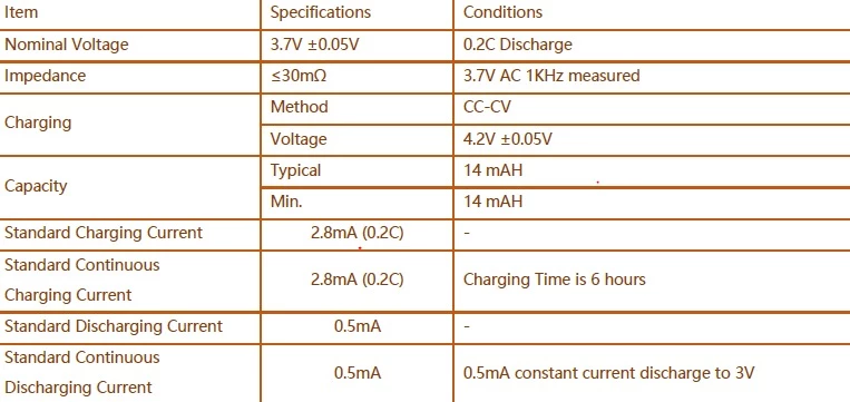

Cbalt.1
Feb 17, 2024 3:43 PM UTC
We could use STBC3 for stand alone application. I want to charge a mini battery as below specification. battery.jpeg
I am planing to draw a pcb that contains USB socket and its power will  be come from 5V phone charger. May I use the STBC3  stand alone to charge this battery or should i put mcu to control charger limits. I confused. Previously I use TP4056 IC to chage higher capacity. It is the first time i am going to charge such a lower batter.  May you give some advise to me.
Best regards.
