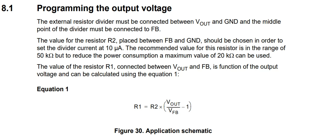

I found this part of the datasheet for the STBB3JCC component a little confusing. Could someone help me calculate the ideal resistor values ​​to have an output of 3.3V?
My board is powered by a lithium battery that varies from 3V to 2V. The output requires 3.3V with a maximum current peak of 500ma. What would be the ideal inductor and output capacitors?
