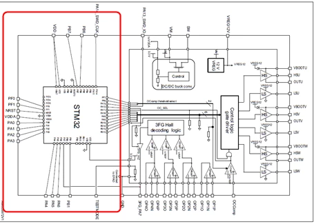

Stand-alone use of STM32 CPU in STSPIN32F0
We would like to use the embedded STM32 in the SPIN for calculation purposes if no Vm power supply voltage is available.
But datasheet is mentioning that Vdd < Vm. And the circuit diagram shows connections between Vdd, Vdda and internal 3.3V.
Question 1: Is it possible to use only Vdd and Vdda (both 3.3V) to run the chip ?
Question 2: Under this condition which max. input current we would have to expect if CPU runs in low power mode ?

Question1: Is it possible to use only Vdd and Vdda (both 3.3V) to run the chip ?
Answer 1: Yes, you can but in this case you will not able to control the embedded gate driver.
Answer 2: Current consumption in Standby mode will be around 125 uA.
