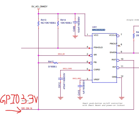

I am trying to reset the power by controlling GPIO3.3V.
However, the initial power is ON and OFF only, and there is no control thereafter.

    Do you have a specific reason for connecting SR, PB and RST together and then controlling that with a GPIO?
    Maybe it would be helpful if you describe what you want to achieve, even better if you attach a timing diagram.
