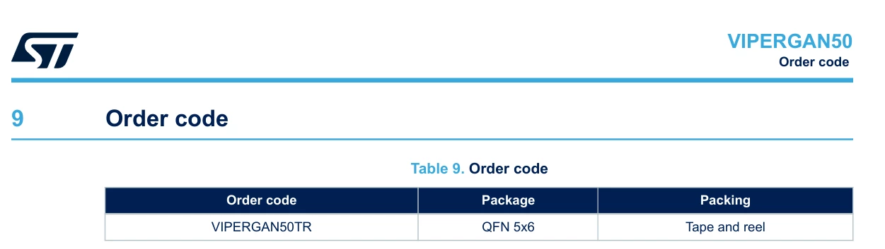

But I have one doubt I am using VIPERGAN50TR for simulation purpose as well in actual hardware . Weather this VIPERGAN50 can be used to simulate the exact behaviour of the VIPERGAN50TR or have any differences between these two which can cause any problems in simulation results ?
Aug 11, 2026 10:10 PM UTC
VIPERGAN50 and VIPERGAN50TR are the same thing.
