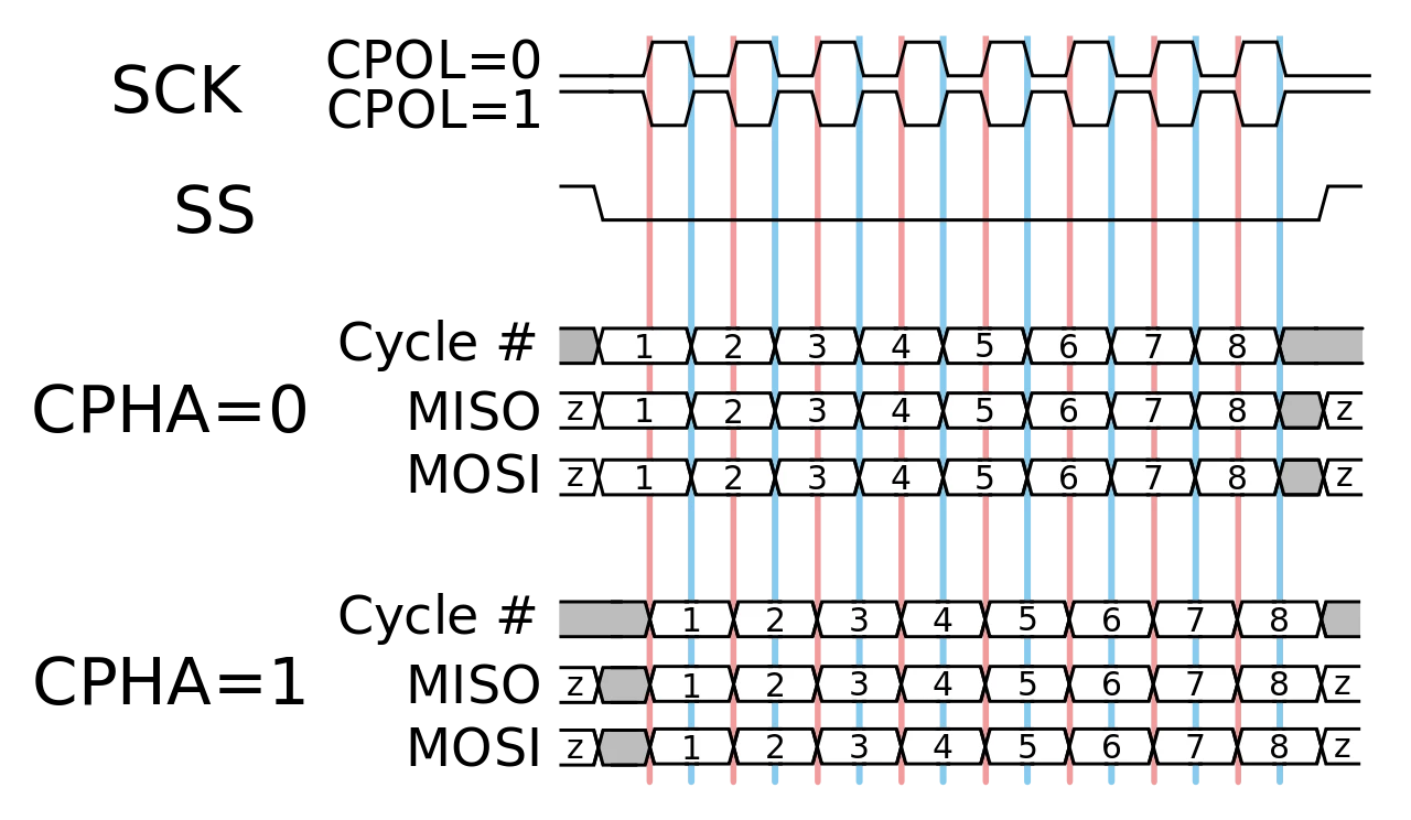

from your pictures the L6474 is behaving properly.
If you do not configure the proper clock polarity and phase the communication fails.
You must set CPOL = 1 as above mentioned and CPHA = 1 (the IC updates the out on the falling edge and samples on the rising edge).
I attach a picture of SPI timing diagram [from wikipedia]:
0693W00000DnurkQAB.pngLet me know if with the proper setting solves your problem.

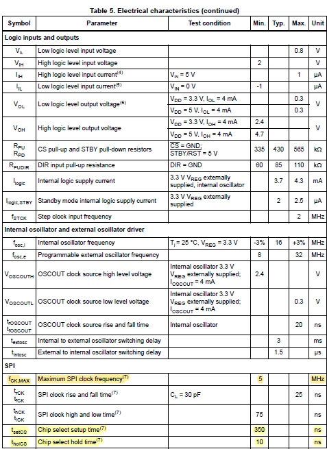

It will be helpful if you have in example code how read the registers and update the registers
Attaching below the L6474 datasheet page in which it is confusing what is maximum speed of SPI
