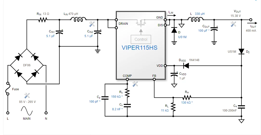

Dear Community,
I was desinged a SMPS for my circuit which belowed picture. Its working on 110V AC and not any problem. But when I connect it to 220V AC output voltage is going down slowly and about 1 minute later its go to shutdown. I can not find any solution. Pls urgent help
