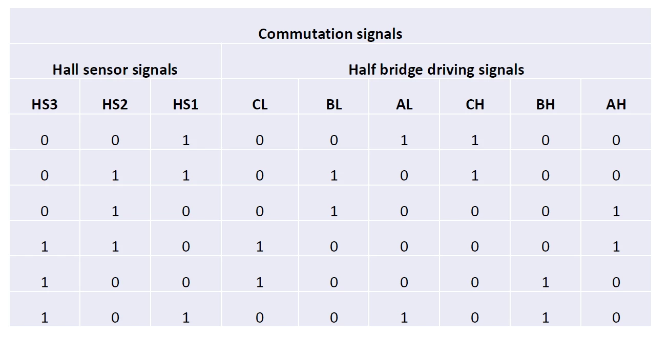

Recently I have bought STEVAL-SPIN3202 board, I have a specific bldc motor which i want to drive. In 6step algorithm , I want to edit the sequence of commutation according to the hall sensor inputs
Please let me know if the board automatically detects the sequence for excitation or do we need to edit in the firmware, if we need to edit it in the firmware in which section I need to edit the sequence in 6step library.

If the sequence of commutation of the hall sensors is not standard, the firmware has to be edited in the function MC_SixStep_NEXT_step included in the 6Step_Lib.c file.
Hereafter I report the first lines of the function with few comments:
void MC_SixStep_NEXT_step(int32_t Reference)
/*!< acquisition of the status of the sensors*/
 H1 = HAL_GPIO_ReadPin(GPIOA,GPIO_PIN_0);
 H2 = HAL_GPIO_ReadPin(GPIOA,GPIO_PIN_1);
 H3 = HAL_GPIO_ReadPin(GPIOA,GPIO_PIN_2);
 hallStatus = (H1 << 2) | (H2 << 1) | H3;

Hello @Cristiana SCARAMEL​ , Thank you so much for your response. So do we need to change Halls status value i.e "case x" or we need to change the value of "SIXSTEP_parameters.next_step_pos=x", its quite confusing for me , I am a entry level developer, please help me with it , for the reference i will attach the commutation table of my motor, please go through it , and help me to solve the issue.

The best and easier way is to change the “case x�? according with your table AND check that spinning direction is the expected one.
Moreover, since the firmware updates the timer registers based on the expected values previously set, I would also suggest to explicit all the capture compare values for the three phases adding the missing ones.
For instance:
case 2:
        SIXSTEP_parameters.next_step_pos=1;
HF_TIMx.Instance->CCR1 = SIXSTEP_parameters.pulse_value;
HF_TIMx.Instance->CCR2 = 0;
HF_TIMx.Instance->CCR3 = 0;
HF_TIMx.Instance->CCER = TIM_CCER_CC1E | TIM_CCER_CC1NE | TIM_CCER_CC2E | TIM_CCER_CC2NE;
Break;
Considering your table, one can observe that it corresponds with the firmware table with the following match:
  • A= half bridge phase U (channel 1)
  • B= half bridge phase V (channel 2)
  • C= half bridge phase W (channel 3)
  • HS1=hall sensor corresponding to H3
  • HS2=hall sensor corresponding to H2
  • HS3=hall sensor corresponding to H1
and
  • reference < 0
Doing so, the first configuration of the table (HS1 =1) would be H3=1 -> case 1 of reference < 0 -> W active and switching (CCR3=pulse_value and CCER= TIM_CCER_CC3E | TIM_CCER_CC3NE) and V active (CCR2=0 and CCER= TIM_CCER_CC2E | TIM_CCER_CC2NE) that corresponds to your table CH=1 and AL=1.
In conclusion, if the table is specified for counterclockwise direction, with the motor connected as above, the firmware should properly work.
If it doesn’t you just need to replace the condition Reference > 0 with Reference < 0.
Let me know if I solved your doubts.

Hey @Cristiana SCARAMEL​ , thank you so much for the response, I need a clarification in the above solution, so in "Doing so, the first configuration of the table (HS1 =1) would be H3=1 -> case 1 of reference < 0 -> W active and switching (CCR3=pulse_value and CCER= TIM_CCER_CC3E | TIM_CCER_CC3NE) and V active (CCR2=0 and CCER= TIM_CCER_CC2E | TIM_CCER_CC2NE) that corresponds to your table CH=1 and AL=1.", since the condition is CH=1 and AL=1, do we need to activate W and V or W and U, cause A->U,B->V,C->W. Please clarify the confusion.

I double-checked firmware and provided decoding table.
Considering that the commutation table refers to CCW rotation, that is the one implemented in the firmware, corresponding to the standard motor configuration in the picture where A, B and C are U, V and W phases respectively.
So, if connections are OK, nothing should be changed.
Otherwise, in case the commutation is supposed to be in the opposite direction, you only need to replace if(Reference > 0) with if(Reference < 0).

Mar 19, 2021 10:41 AM UTC
Hey @Cristiana SCARAMEL​ , the previous solution which you had gave me worked at some extent, like the motor could complete one spin (with a small **** or it may have skipped one step)and stopped due to the error, but according to the recent solution the motor is not even spinning its just stalling. Please do let me know what to do in this situation, it is very important for me to run this motor with the help of STEVAL board,
