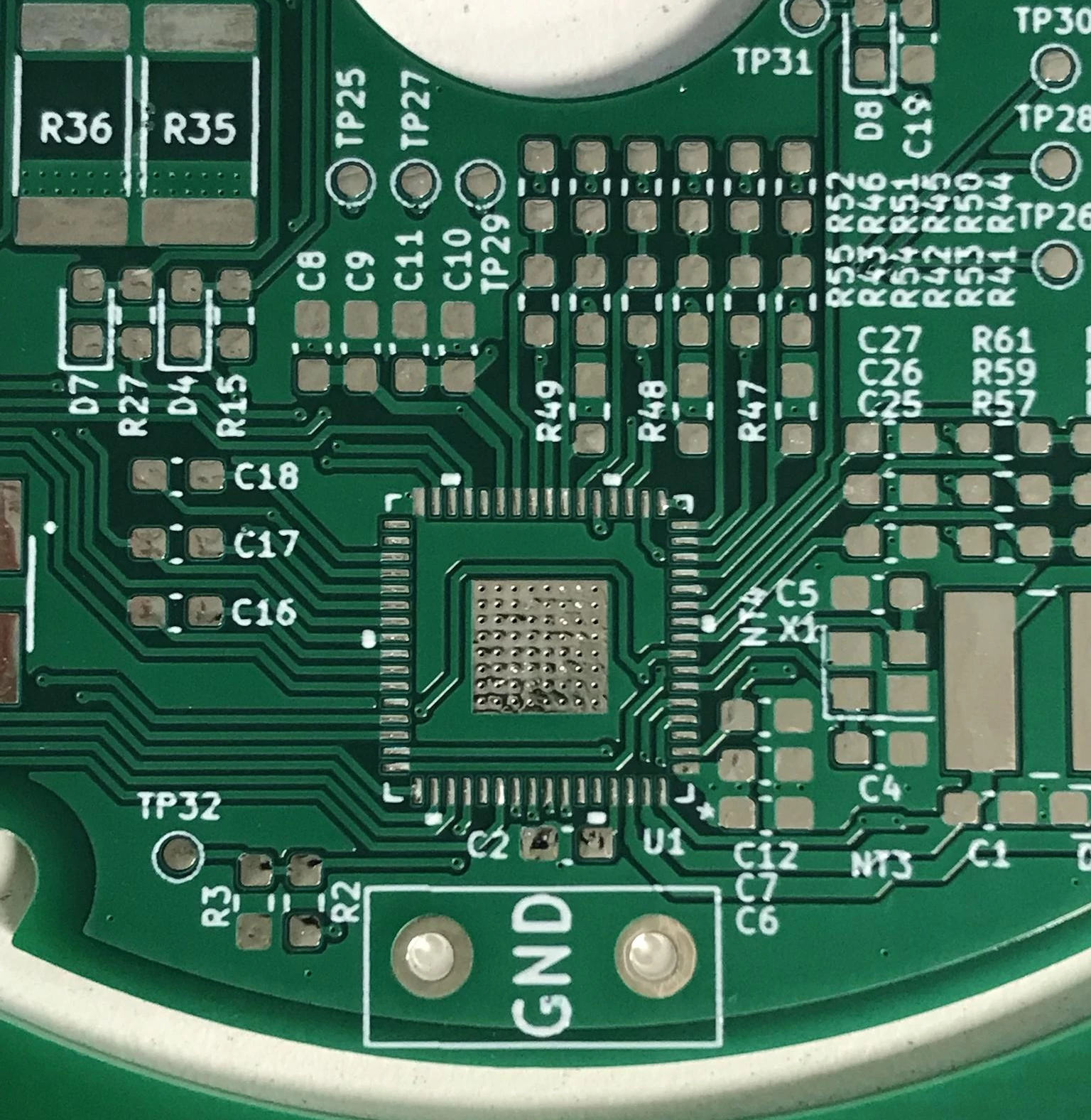

Hi, we are facing a strange problem with your MCU + GD combo - STSPIN32G4.
In general, about 60% of soldered ICs are not working properly, we test on the default firmware generated for EVSPIN32G4 and we get error "64 overcurrent" and / or gd_nfault and gd_ready flags are false (which is bad).
We use our own PCBs, so far we have tested >50 chips, because we are in the R&D phase, we solder the chips inhouse using various methods:
  • preheater + hot-air,
  • hot-air,
  • infrared oven (with the appropriate profile).
We haven't yet baked the chips according to the JEDEC (J-STD-033D) procedure.
We switched to SPIN32 from DRV8323 from TI, which we've never had such problems with.

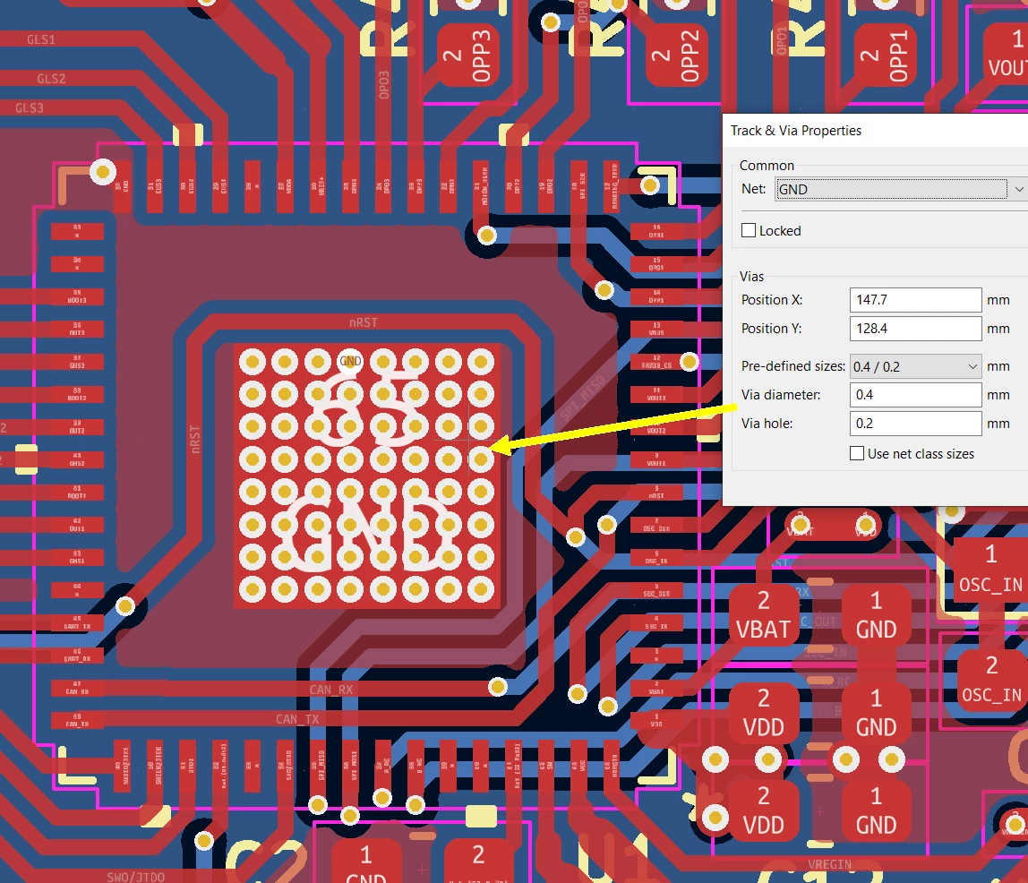

We suspect a problem during assembly, although the technician has experience with QFN / SMD soldering (and with DRV8323 there were no such problems). Or the problem with damp chips. Or possibly poor layout, due to generic centerpad footprint (autogenerated by Ultra Librarian) - lot of tiny vias, that come out "blinded" / impermeable, no air will pass, let alone the tin, I attached cutout picture of what I mean:0693W00000LxZWsQAN.png0693W00000LxZerQAF.pngPCBs were mnfg by JLC.
Motor control schematic is based 100% on EVSPIN32G4 schematic, and we can get some of the MCUs to work, and when they do, they're great little beasts.
ICs itself were purchased from Mouser late last year and from Farnell like 5 days ago.

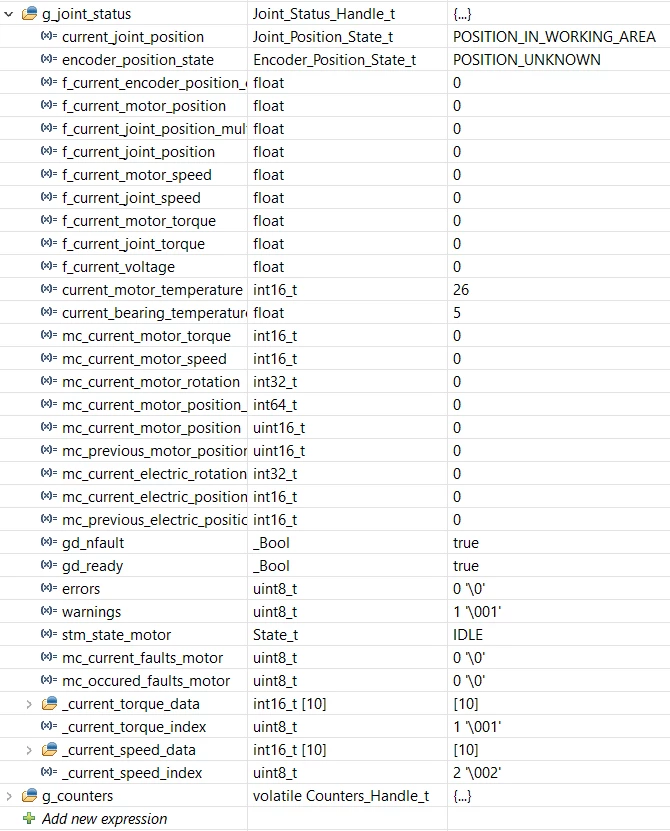

Are you using the STM32 Motor Control Workbench (X-CUBE-MCSDK)?
Could you share the STATUS register content before starting the motor and after the fault event?

Hi, @Cristiana SCARAMEL​.
Yes, We're using X-CUBE-MCSDK.
Here are status registers, before starting motor, so g_fsm_status:state is FSM_INIT
0693W00000LxpwmQAB.pngOn this particular board, motor won't start at all, even tho gd_nfault is true (so correct), no error occurs, and stm_state_motor is RUN. On other boards, there are indications, that there's some problem, like false-positive "error 64 - overcurrent" or gd_nfault == false.
In general, after soldering new chip, motor starts to spin, tho not always.
Is there a problem with our PCB layout? Soldering technique? Storage method?
If it is, its weird that MCU part always works (we can talk with rest of the system, program MCU ofc), but GD part gives Error 64 or gd_nfault == true.
We could switch chips over and over again, but it doesn't make much sense. We need to figure out why this all is so inconsistent.

Hi @KKost.3​ ,
I meant the contents of the device STATUS register, refer to STSPIN32G4 datasheet at page 33.
We try to understand the actual condition of the device before starting and when fault event occurs.
