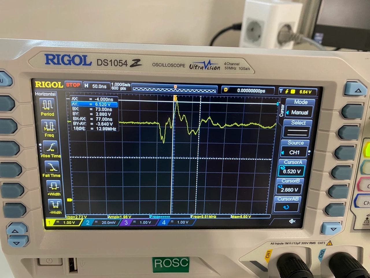

    While checking with a voltmeter didn't show any anomalies, today re-checking with a scope revealed that when laptop is plugged in and i connect sth to a usb port, I sometimes get a spike of around 7V for around 10ns.

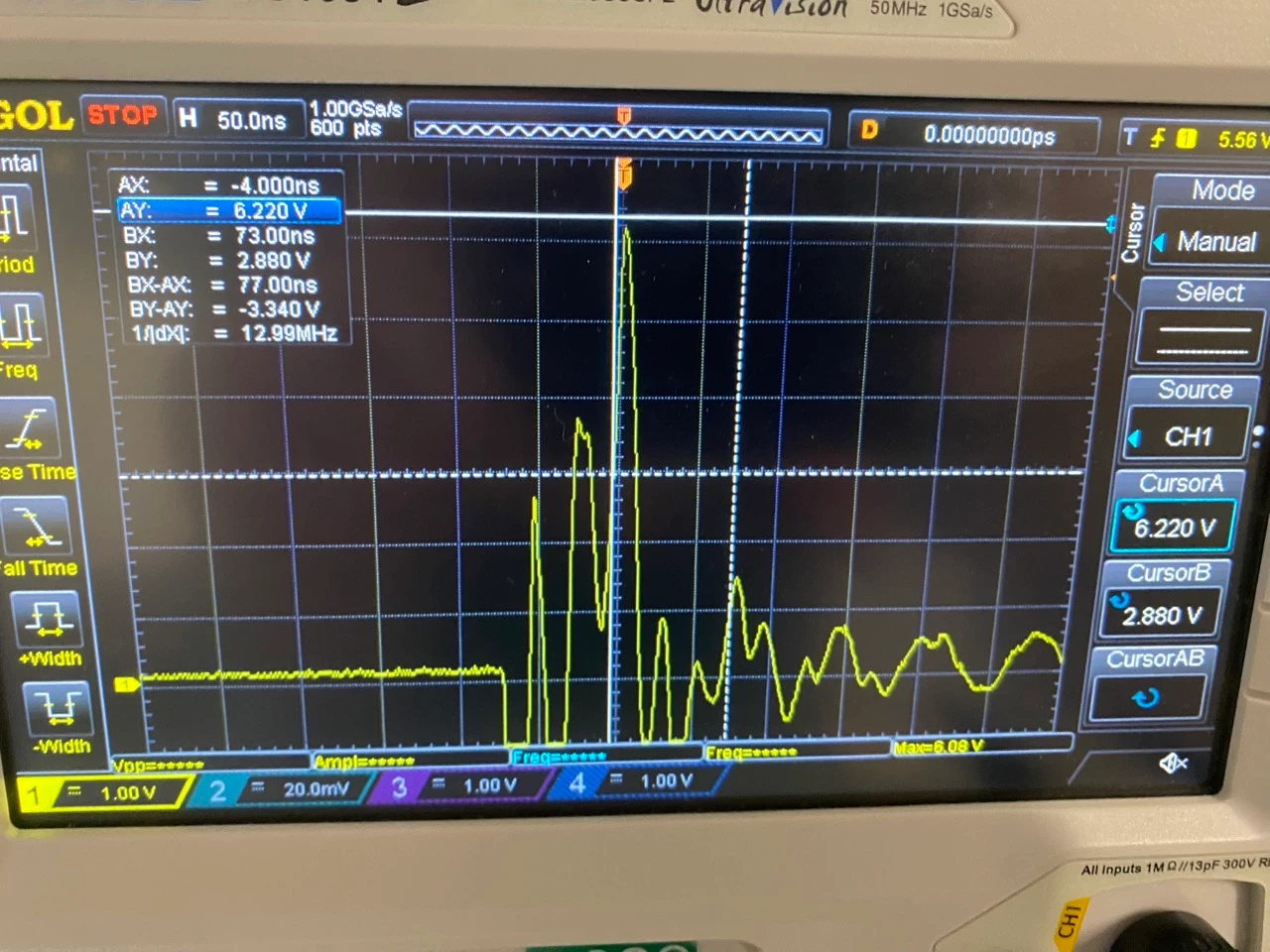

    Crosschecking with a Surface Pro, I did not get spikes when plugging in the usb peripherial probe, but when plugging in the charger, a similar thing happened:
    So, is this likely to be the thing frying the Nucleos?
    The thing is that when plugging in my MBP, there are no spikes on the output, but thats what led to a burnt LDO. Could it be related to USB enumeration?
