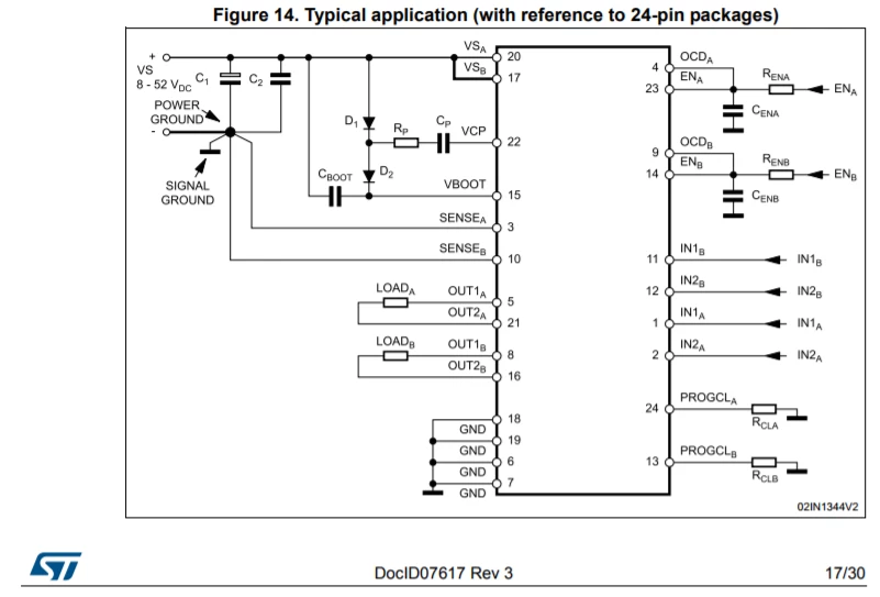

My aim with strong low pass filter was to average signal that I measure with adc and avoid getting noisy measurement. Any idea how to synchronize reading of adc with pwm signal in cubemx code?
I am changing PWM with __HAL_TIM_SetCompare call (cubemx). Code available here:
https://github.com/zhivko/EclipseStm32/blob/master/Src/main.cpp#L254-L270
Also another idea - could it be that I am experiecing ground noise? From datasheet it seems shunt resistor should have very short ground path - see picture from datasheet? Please comment.

Ground noise generated by long sense paths is an high freq noise generated by commutation by inductive effects. If you sync in the middle of the ON time as described, you will sense the current far away from the peaks.

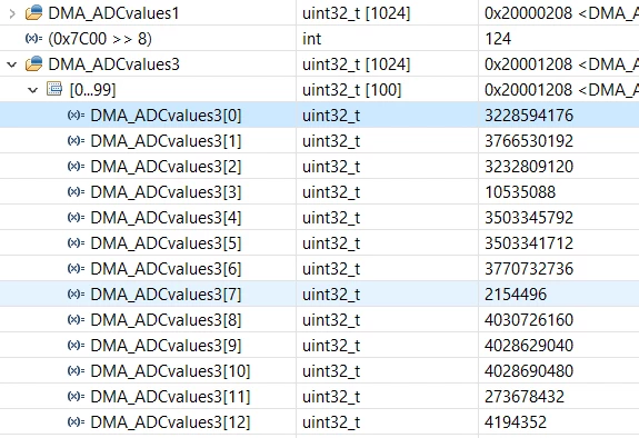

ADC values are here, but it is funny how they difference of one measurement to another is quite big - could it be that they are indeed correct or possible, or it is some flaw in my program?
I am using:
hadc3.Init.Resolution = ADC_RESOLUTION_12B;
and
sConfig.SamplingTime = ADC_SAMPLETIME_2CYCLES_5;
Should I use half word, or word in dma alignment?
hdma_adc3.Init.PeriphDataAlignment = DMA_PDATAALIGN_WORD;
zhivko zivkovic
Nov 26, 2017 2:04 AM UTC
Posted on November 26, 2017 at 02:04
OK found the mistake... I was using,
hadc1.Init.DataAlign = ADC_DATAALIGN_LEFT;
instead
hadc1.Init.DataAlign = ADC_DATAALIGN_RIGHT;
Also I found out that using:
        hdma_adc1.Init.MemDataAlignment = DMA_PDATAALIGN_HALFWORD;
is OK.
Now I got reasonable results, thanks for all help, there is a code under git link I post above - maybe it helps somebody.
