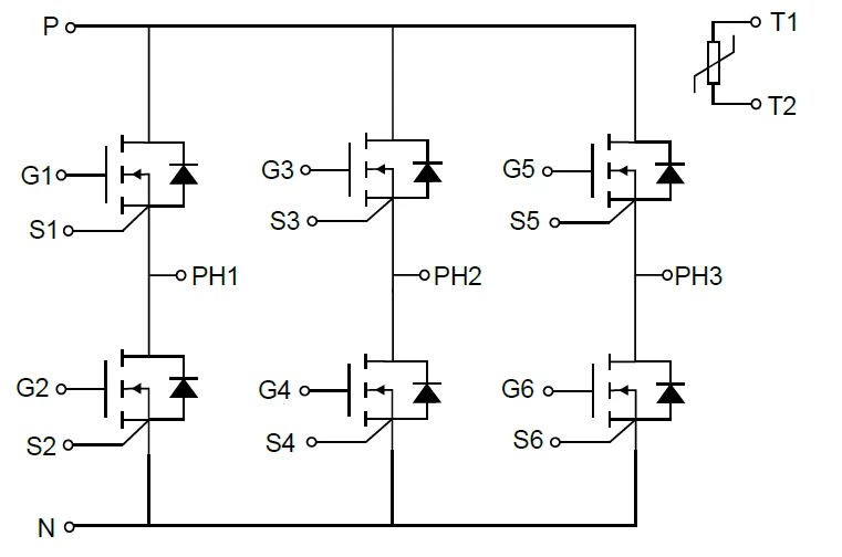

We want use sixpack SiC Power MOSFET module for drive a low power hi voltage motor.
For safety reson I want measure the phase currents with 3 shunts connected beetween low side source and negative, instead one. With this package aren't avalable the power low side sources pin, but only signal low side sources (S2 pin 22, S4 pin 26 and S6 pin 30).
Are there some issue, other than noise and voltage drop, like low section wire bonding, about use signal low side sources for connect the shunts leaving negative (pin 1-2) disconnected?
Thancks
good idea.
So no source pin - nothing to connect the R .
= these are the Kelvin source connections for the driver. NOT for power to gnd.
-> So you can use only one shunt N---gnd/neg to measure the sum current. Thats it.
