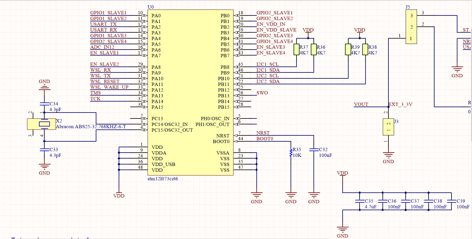

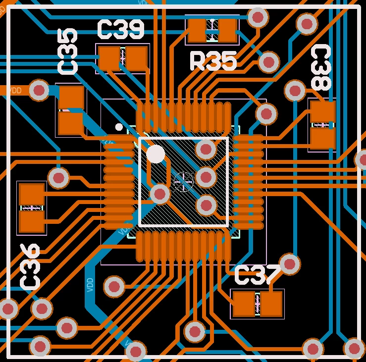

On my nucleo-l073 board, my software can run in stop mode and consumes only 3uA. I decided to make my own PCB but i can't figure out why the consumption can't reach 3uA. Actually, i'm running around 25uA with the same software. I'm using a stencil and a reflow oven to solder the components (T-962) and the solder paste is a Sn63 Pb37. I'm making the pcb by PCBway and i take the cheapest quality (5$ for 10 pieces : TG 130-140 (i don't what it means)), do you think it could come from that ?
I have also noticed when i put my finger directly on the stm32, consumption often decreases.
If you have any ideas, please feel free to share
Thank you in advance.
Edit : I join in attached file my schematic and my PCB (the ground planes are not displayed)

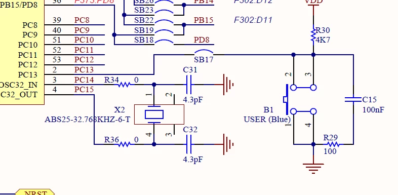

I have noticed when i connect the pin 2 (PC13) to the ground, my current consumption is around 2.9uA (exactly what i want and this is exactly the same current consumption as the nucleo board). But it is not indicated in the datasheet that this pin should be put to the ground and on the nucleo board, this pin is not put to the ground.

Is it the same package? More GPIOs? Are they polarized properly? Oscillators are all same and off? Reset signal? If there are some pull-ups and pull-down, you could have few uA there. Example would be I2C Pull-ups and SW is stopped while I2C bus lines were used and are low level.

No, it is not the same package, i'm using a stm32l073cbt6 (48pin) whereas it is a 64pin on nucleo-l073.
To test, on my own board, i'm only soldering the stm32, the pull down resistor (10k) on boot0 and all decoupling capacitors.
I m also loading the same firmware on my nucleo board or my custom board (so all peripherals are deactivated, only RTC (running on LSI) is on and ADC).

since the package and the pinout is different, maybe there are some slight differences in the way the GPIOs have been configured. Did you check whether all the pins that you don't need are actually configured as analog with no pull on your custom board?

I'm still sorting out some of the intricacies of STM32s, how the parts come out of reset, and the software framework, but I suspect, based on what you've said thus far, that PC13 is still configured as an input.  Even though the actual peripheral functionality may be deactivated, if the input buffer is still on, leaving this floating would result in internal oscillations and shoot-through currents in the input totem.
Looking at the Nucleo schematic, PC13 is used by the the blue pushbutton and has a PU to VDD, so it's being held in a known logic state.  If you cut the solder bridge, you would probably see similar current consumption on the Nucleo.

Exactly, when i cut the solder bridge SB17, i have the same bahavior with unregular current consumption, even if i set this pin with an internal pull up or pull down ...
So my question is : is it preferable to put a pull up with a 100k resistor or directly connected to the ground ?
