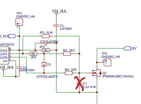

MOSFETs Q1, Q2, Q9, Q10 damaged when applying 230 VAC input with STGAP2SICS gate drivers
Problem Summary
We have developed a three‑phase servo motor drive using STGAP2SICS isolated gate drivers and IPW65R190C7XKSA1 MOSFETs.
The inverter works perfectly at low DC input voltage (25–40 V DC).
However, when we apply 230 V AC (rectified ~320 V DC) and send control signals to the U, V, W inputs, MOSFETs Q1, Q2, Q9, and Q10 fail immediately, even under no‑load condition.

  • Only the U‑phase high‑side and low‑side MOSFETs fail (Q1, Q2).
  • Same issue happens in the W‑phase (Q9, Q10).
  • MOSFETs fail instantly as soon as the PWM is applied at high‑voltage input.
  • No load connected to the motor during testing.

  1. STGAP2SICS gate driver configuration
    • Proper BOOT strap design
    • Recommended gate resistors (turn‑ON / turn‑OFF)
    • DESAT protection setup
    • Miller clamp usage

Peter BENSCH
Jan 30, 2026 8:37 AM UTC
Welcome @Nithi, to the community!
Is there a specific reason why you are using a driver for SiC MOSFETs for Si MOSFETs?
Perhaps you should consider the p2p replacement STGAP2HS instead?

Jan 30, 2026 1:57 PM UTC
1. I hope you have no 0,1u there !  NO cap here.
2. gate resistors: i would start with value from ds : 10 + 10 ohm
3. remove D1 . (what should it do useful ?? )
4. with new mosfet ... :)  , no HV power supply + load : check with dual channel scope the gate signals !
looks like this:
(for this test connect scope probes + ground to hi+lo gate + source ; without any supply on HV !!!)
IF they look fine, remove probes,  try with HV (30V or so) ; if good , = almost zero supply current , apply some load.
IF all fine, try with full HV .
