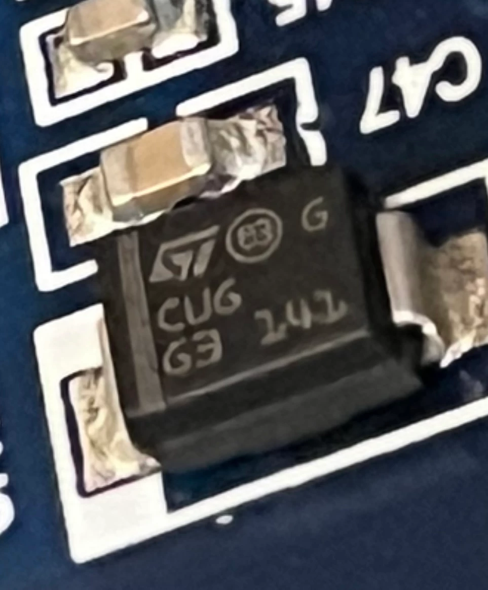

Hello @RichG
Can you add the board reference here.
Best regards.
II
Peter BENSCH
Sep 22, 2023 5:46 PM UTC
Welcome @RichG, to the community!
the marking of the device is CUG which stands for the SMBJ16A, a 600W TVS in SMB package.
Hope that answers your question?
