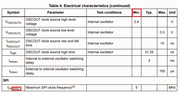

Min. SPI Baudrate PowerStep01
According to the datasheet of the powerstep01 driver, a minimal baudrate of 5MHz has to be respected for the SPI interface. Is there any technical reason for that or can a lower (lets say <1MHz) baudrate be used for communication?

Cristiana SCARAMEL
Jan 12, 2023 1:00 PM UTC
Hello @pf8645​ and welcome to the ST Community.
The 5 MHz is the Maximum SPI clock frequency - see powerSTEP01 datasheet at page14.
So you can use a SPI clock frequency lower than this value.
Let me know if I solved your doubts, if so please "Select as Best" label.

Peter BENSCH
Peter BENSCHBest answer
Jan 12, 2023 1:10 PM UTC
In fact, the data sheet is somewhat misleading at first glance because it does not state the
  • SPI clock frequency
but rather the
  • Maximum SPI clock frequency
as mentioned by Cristiana.
Regards
/Peter
pf8645
pf8645Author
Jan 12, 2023 1:55 PM UTC
Thanks a lot for the answers, I was indeed a bit confused by the datasheet, since the max frequency is stated in the "min." column.
