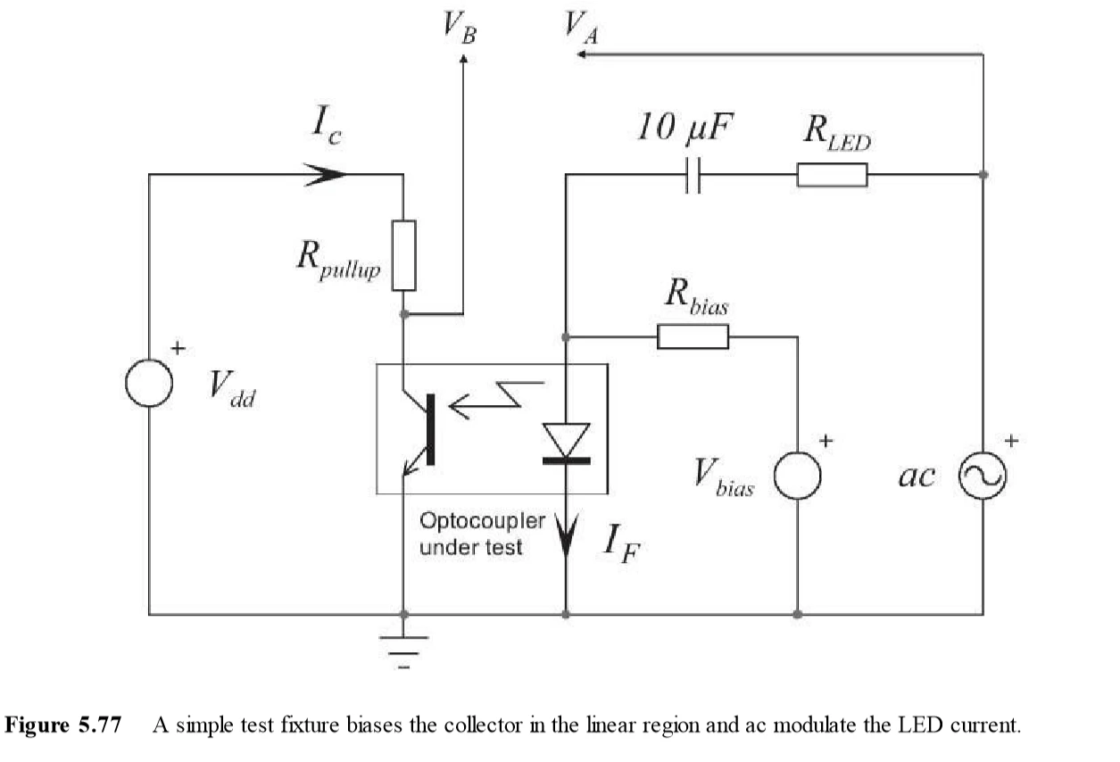

Measuring the frequency response of an optocoupler (e.g. PC817C) with different pull-up resistors using a Bode 100.
  • March 9, 2022
  • 1 reply
  • 1197 views
My test reference circuit is from Mr. Christophe Basso's book: "Designing Control Loops for Linear and Switching Power Supplies By A Tutorial Guide"
The picture is showed as follow.
0693W00000KbyHuQAJ.pngUnfortunately, it may be a problem with my test circuit, or maybe the Bode 100's are not set up yet and I'm not getting results.
