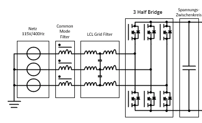

I am using three Mastergan1 in a 3phase Rectifier.
When the Grid is switched on the circuit
charges the DC link Capacitors uncontrolled.
I am planning to build a “switch on�? circuit.
How much current can the Mastergan1 handle in an unpowered state?
Is there a different between unpowered and powered?
Thanks for you help
