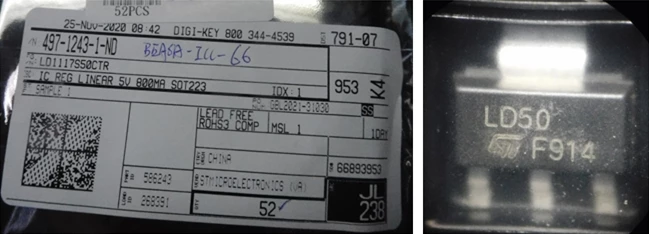

Marking Information LD1117S50CTR
we have purchase this item LD1117S50CTR recently,
Can i get the marking information,
our QA department is asking us provide information to process production, thanks.
Winfred LU
Winfred LUBest answer
Dec 4, 2020 7:17 AM UTC
F: assembly plant F = Tongfu Microelectronic in China
9: assembly in 2019
14: assembly in work week 14
1 reply
Winfred LU
9: assembly in 2019
