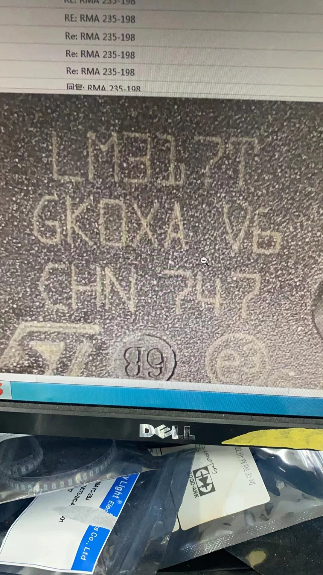

LM317 丝印
  • December 4, 2023
  • 1 reply
  • 1100 views
能具体说明第二三行,代表的是什么呢?
Best answer by Tesla DeLorean
Assembly plant, Defusion site
Assembly country, Year and Week
1 reply
Tesla DeLorean
Tesla DeLoreanBest answer
Guru
December 4, 2023
