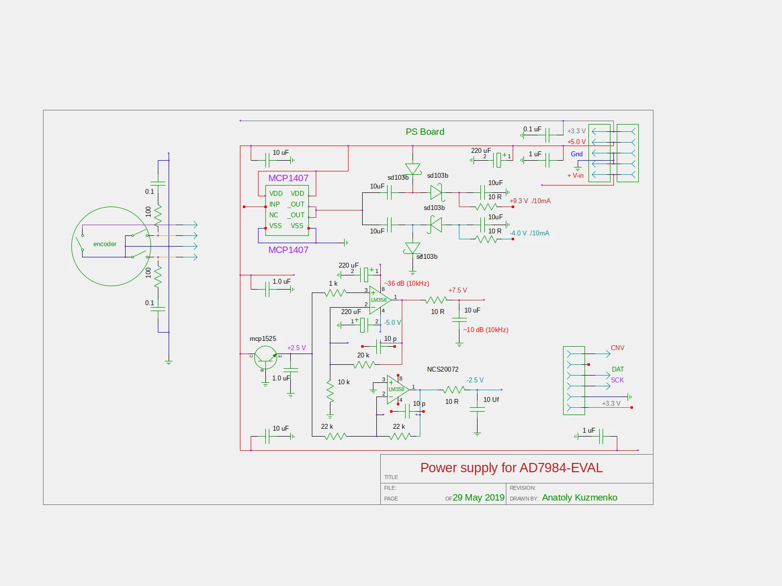

Op-amp "ultra low noise regulator" I designed for AD adc module:
graeme1
graeme1Author
Aug 24, 2023 3:23 PM UTC
Many thanks for your time and the detailed answer.
The L79L datasheet does suggest that the output voltage should be between -11.4 and -12.6 with an input of -14.5 or higher. Our DCDC (which switches at 800kHz) has a steady 15V when measured under full load (without the L79L connected).
We can't really avoid low ESR caps on the output, as most of the other devices that it powers require these.
It's funny that the onsemi MC79L behaves much better. I would have thought they are pretty much the same inside.
