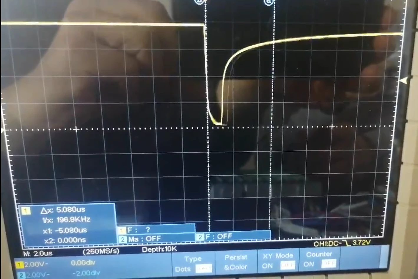

Hi
We observe sudden changes and flickering especially at low level luminosity.
attached oscilloscope capture_1 is taken at one of green LED channels. During the dimming cycle, the ghost pattern causes momentary flashes in LED brightness.

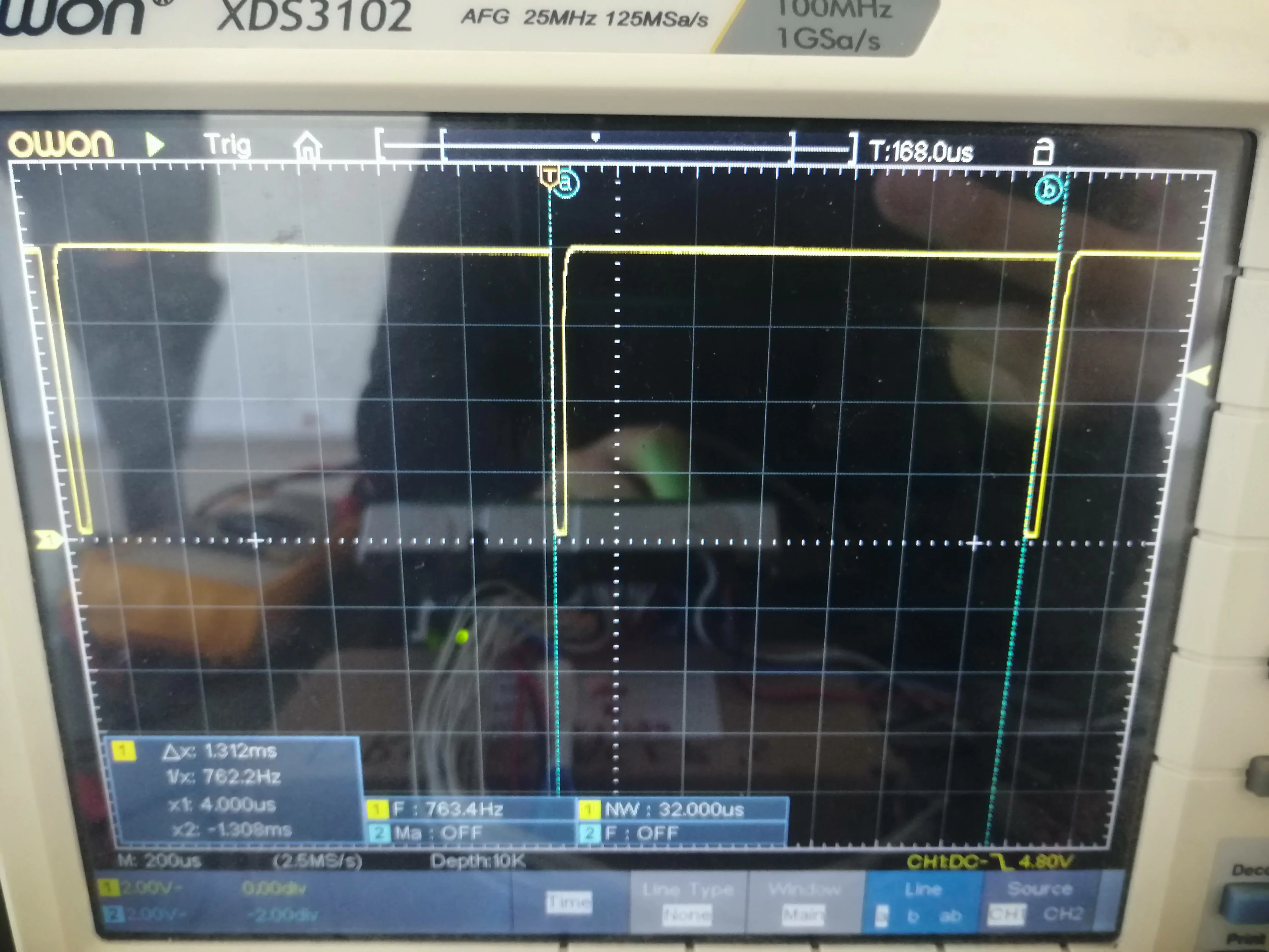

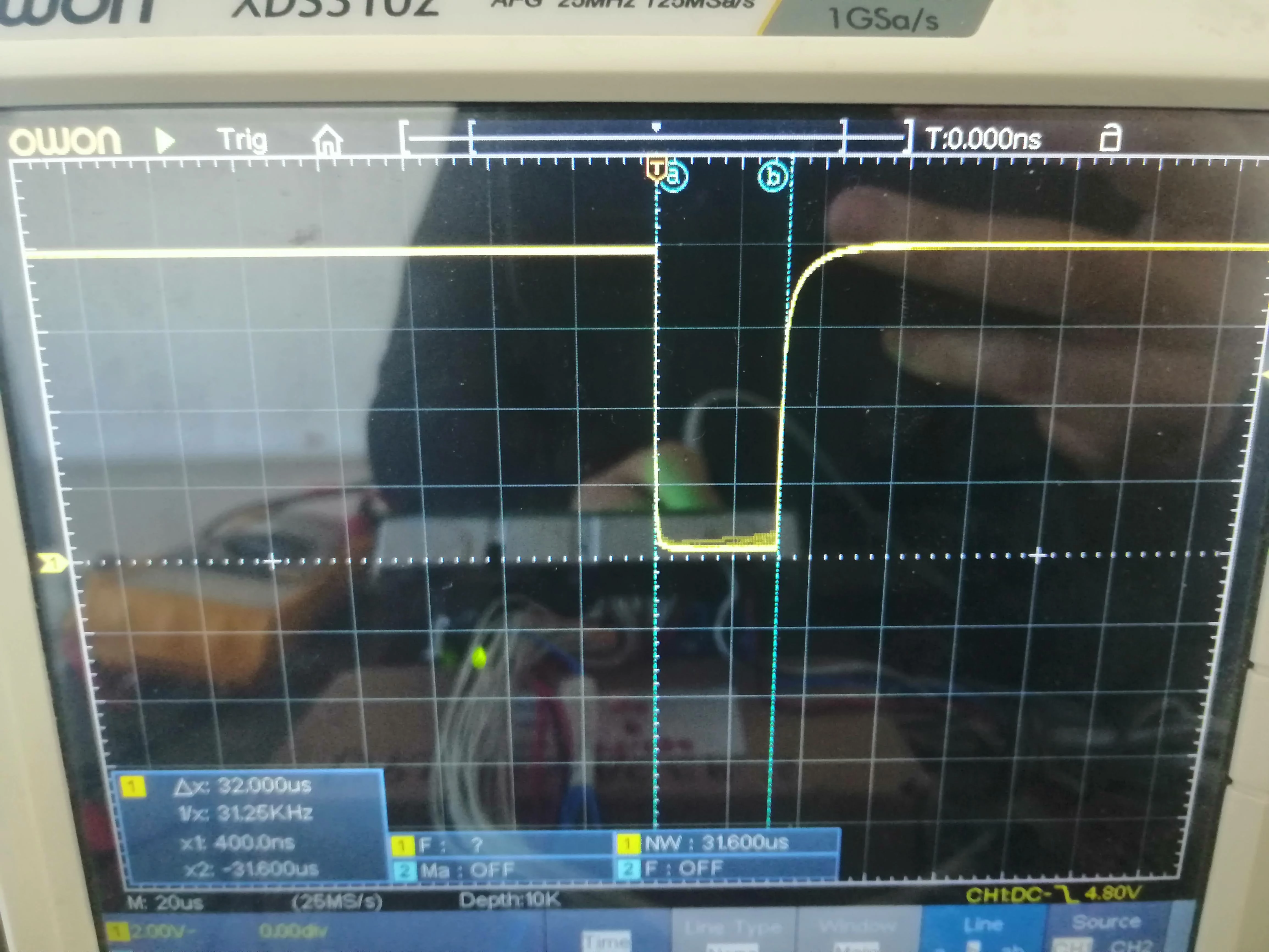

again oscilloscope capture_2.PNG and oscilloscope capture_3.PNG are taken at one of green channels. In this case LOW side resistor of output driver value decreased; and noticed a noise at ON state. There is also a flicker in this case and we suppose the cause is the noise seen in oscilloscope capture_3.PNG.
The flickering and flashing mostly seen at low luminosity values.
Do you have and suggestion on fixing these?

b_1Best answer
Mar 17, 2022 8:30 AM UTC
SOLVED
C19 (parallel to Riseth resistor) marked as NC in the evaluation board schematics, was populated in our design. Removing this cap. solved the problem.
