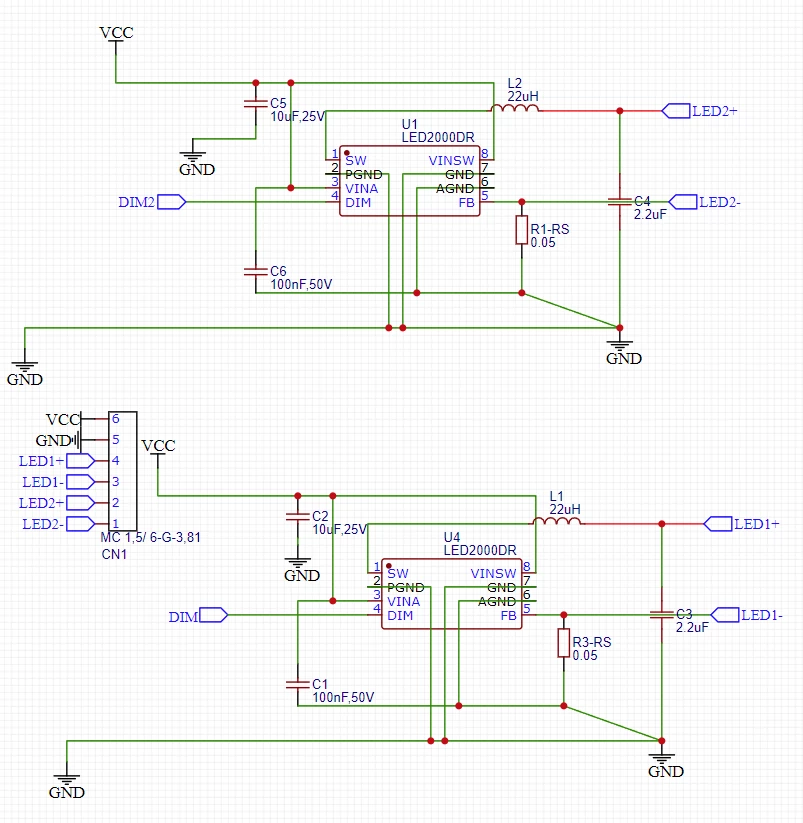

LED2000DR exploding
I am having some issues with a LED2000DR, when connecting to a 12V battery 1/10 times one of the drivers just explodes, and starts to smoke, what is going wrong? Battery is supplying 12V (UL7-12), see the schematic attached.
