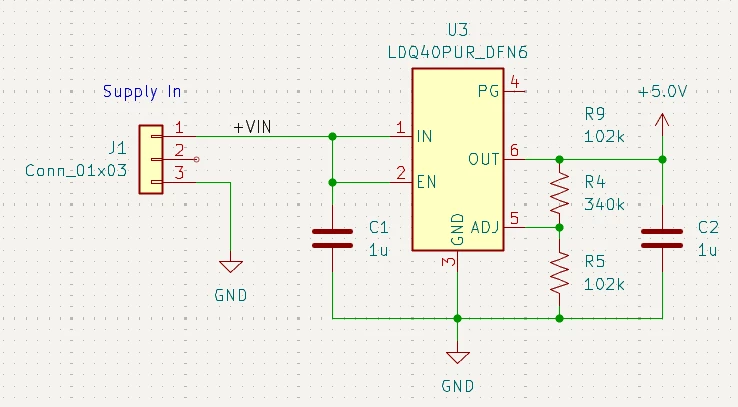

I am evaluating the LDQ40PUR (adjustable version) and there is some ambiguity in the datasheet for setting the output voltage.
The datasheet states:
The resistor divider should be selected as follows: VOUT = (1+R1/R2)*VADJ, considering IADJ negligible.
What is VADJ? Should this be VREF (1.2V)?
I assumed VADJ = VREF = 1.2V, and calculated my output with the following values:
R1 = 340kOhm
R2 = 102kOhm
VOUT = (1+340k/102k)*1.2V = 5V
However, when I built the circuit with these values, I am not getting this value at the VOUT pin.
When VIN is 3.6V or higher, I get VOUT = VIN (e.g. VIN=7V, VOUT=7V)
Here is the schematic for my circuit:
Schematic for LDQ40PUR test circuit

​@JoshuaT Something seems to be wrong with your setup and/or measurements: even if the 7V reach the output unchanged (as ​@TDK says, the cause must be found), then the divided voltage should be present at pin 5, i.e. 102*7V/(102+340) ~ 1.62V.

Welcome ​@JoshuaT, to the community!

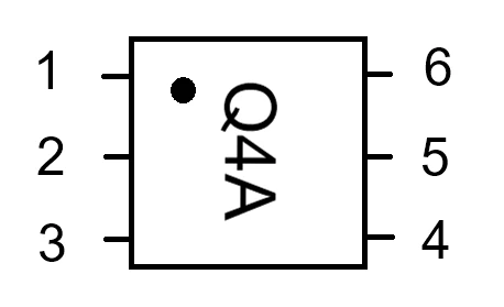

Your schematic is correct; with 340k+102k, your output voltage should be 5.2V when the input is 5.7V. In the worst-case scenario at 250mA, there could be a drop-out of up to 1V, meaning 6.2V would be required.
Are you sure you haven’t accidentally soldered the device on rotated by 180°?
What voltage do you measure at pin 5 when there is 7V at the input?
Regards
/Peter

There are some mistakes in my math in my post, I am actually targeting 5.2V as you deduced.
With 7V at pin 1, I see 3.87V on pin 5.
I have it soldered as follows:
Is this the correct orientation?
