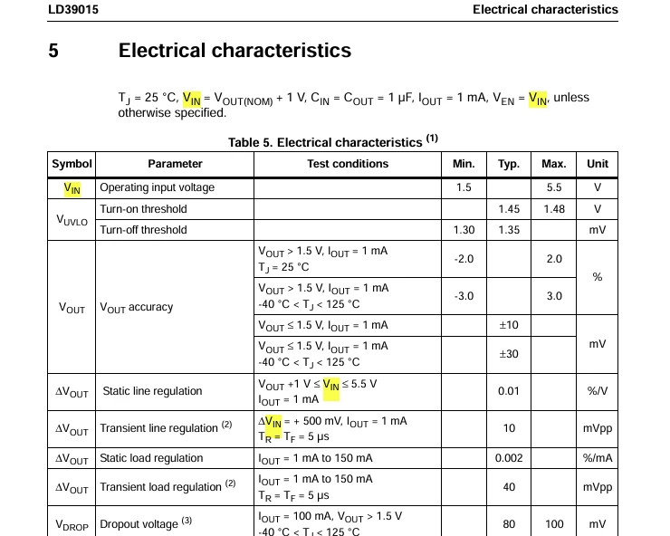

Im planning to use the LDO LD39015M12R with 1.8V Vin, VOut=1.2V 5mA load current. the drop out voltage is 80mV but the datasheet shows the condition of Vin= Vout+1v in the  electrical characteristics table.
My case will not meet this Vin=Vout+1V condition, will it be a problem or the LDO will work as the drop out voltage is met.
Please share your though as soon as possible team.

LDO will functioning as a regulator with slightly lower specification for: PSRR, line regulation , load regulation.

how to find the PSRR , line regulation & the load regulations for my case, do we have any way?

Measure

Dropout is 100mV max, so it will work.
