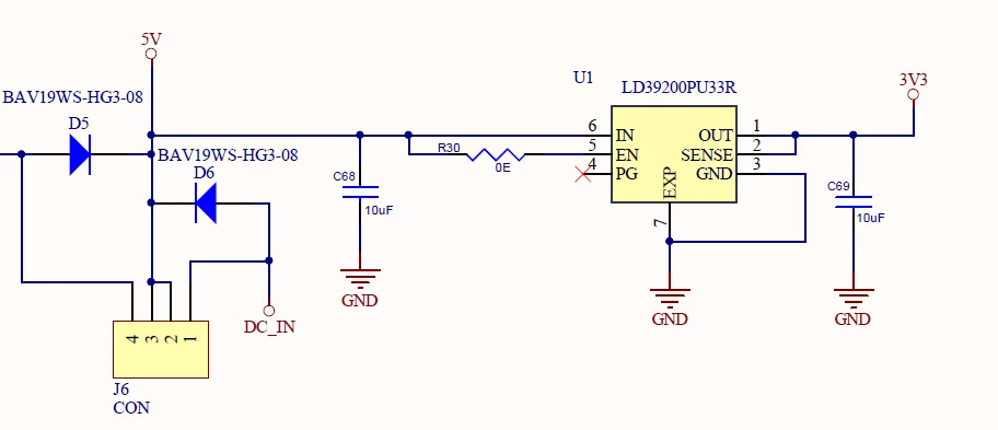

Hi, recently we purchased LD39200PU33R Fixed voltage circuit.i have to give 5v input voltage but i get 4.7V..that datasheet mentioned 3.3V..expected voltage i didn't get..

    The schematic looks OK and identical to the one in the datasheet. Please double-check if pin 2 (SENSE) is really connected to pin 1 (OUT).
    If all pins are connected correctly, there is only a possible defect in the component, since the control transistor is fully turned on if the output shows 4.7V.

    Hi peter.. thank you for your reply..i got the output..The problem is capcitor value is not matching.
