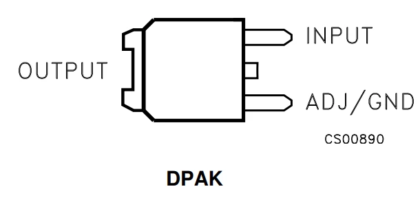

LD1086 DPAK pin configuration
  • October 16, 2023
  • 1 reply
  • 1275 views
Do we have a clear Pin Numbering configuration for this component as pin numbering which is 1,2,3 the datasheet did not clarify clearly.

Welcome @Sakura, to the community!
You can see the pin assignment actually also in the drawing of the TO-220, which is essentially the same as the arrangement on DPAK and P2PAK:
  1. = ADJ/GND
  2. = Output
  3. = Input
Hope that helps?
