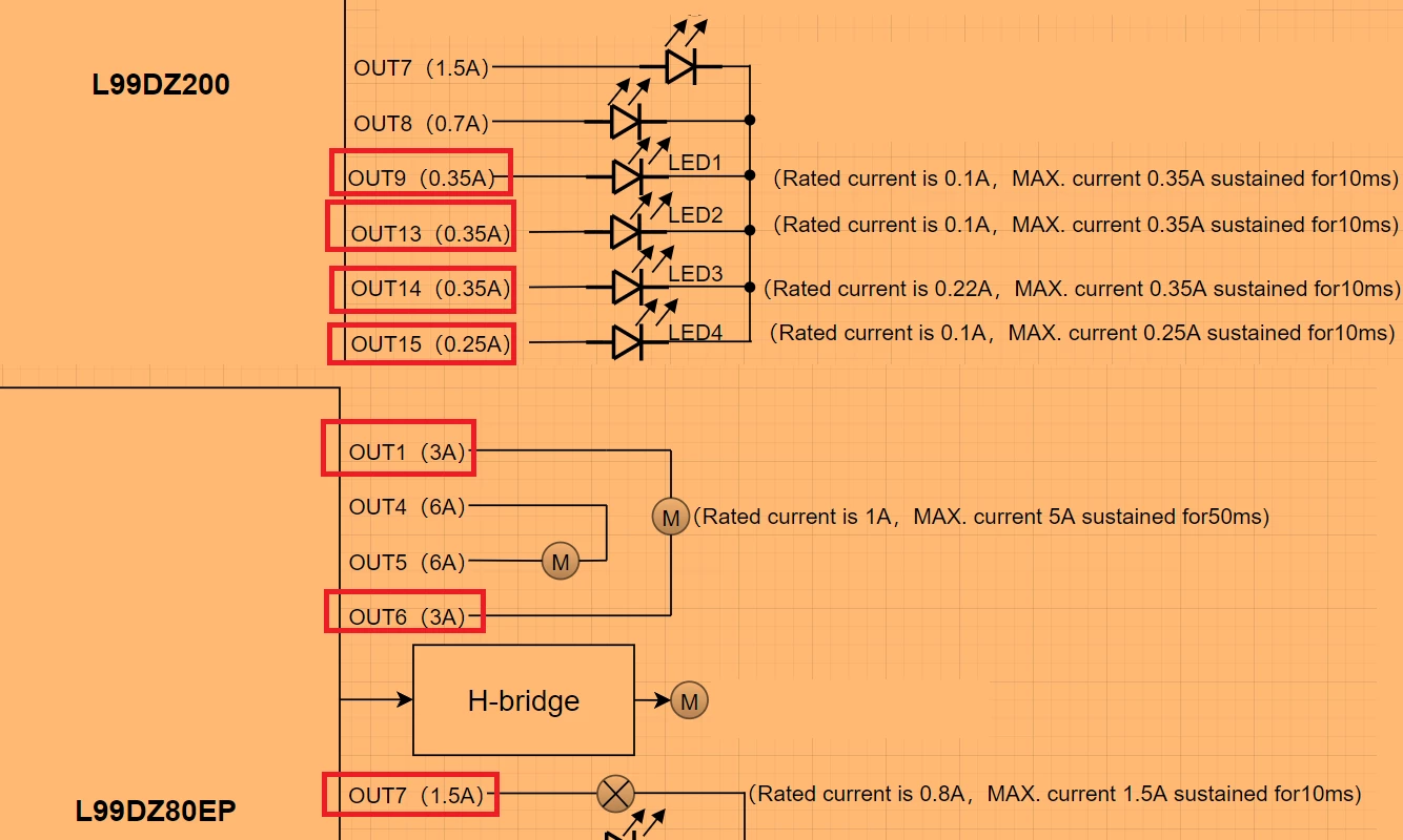

L99DZ200 & L99DZ80EP Load overcurrent problem
if L99DZ200 OUT9,13,14,15 & L99DZ80EP OUT1,6,7 will trigger overcurrent protection?
