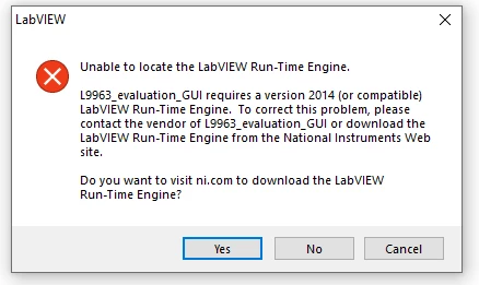

l9963e graphical user interface install
This taype issue acoures while i downdold GUI alrady in pc Labview 2014 persent but this problem comes while instalition KIndly help in instaltion

Mar 21, 2025 4:45 PM UTC
NI labview-runtime 2014
http://www.ni.com/download/labview-run-time-engine-2014/4887/en/
NI VISA-RUNTIME
http://www.ni.com/download/ni-visa-4.6.2/1605/en/
FTDI driver
https://www.ftdichip.com/Drivers/VCP.htm
L9963 demo board usb driver
Shared folder / Jtag_usb_Driver.zip
After install all these software/driver, reboot PC
