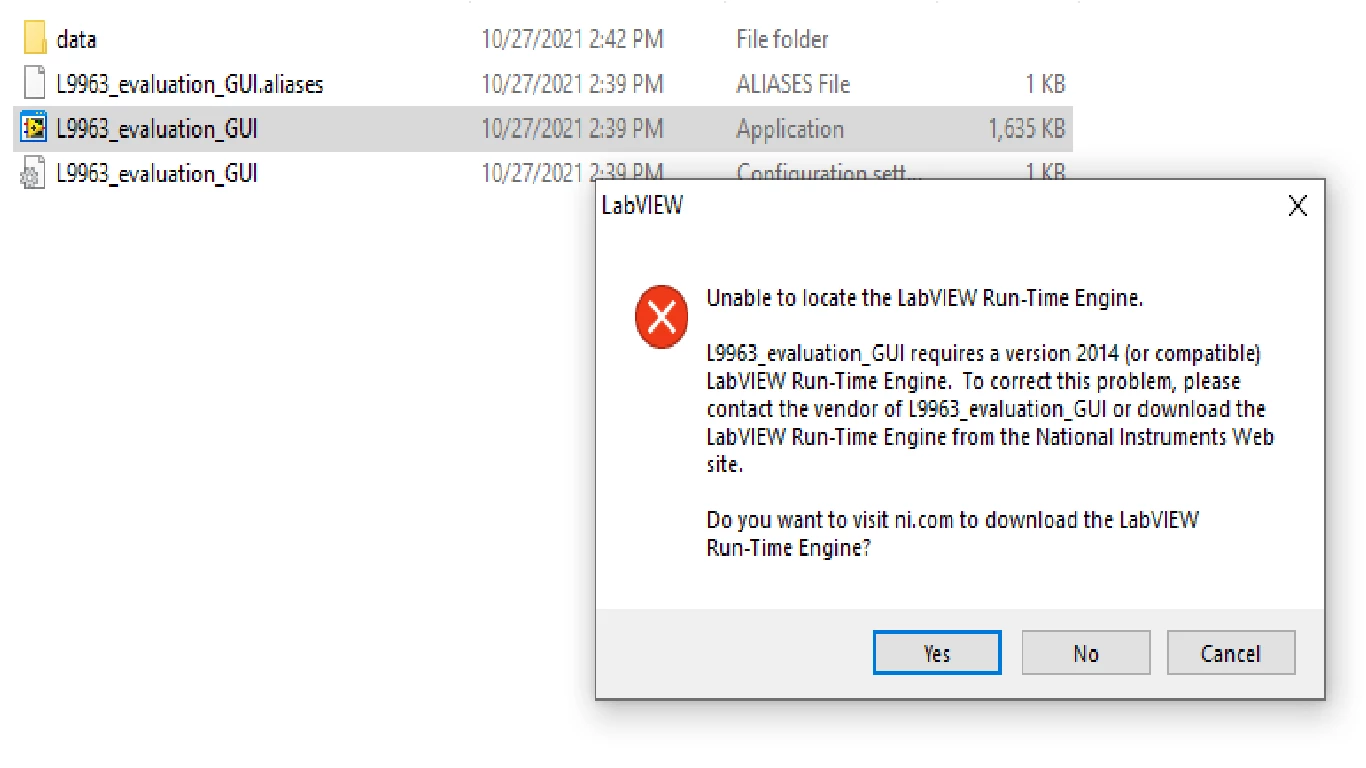

L9963_evaluation_GUI this software is unable to install in my laptop
  • September 19, 2022
  • 1611 views
when i am installing the software a pop up is coming like "Unable to locate lab view run time engine"
i have tried the
1> NI Labview-runtime 2014
2>NI-VISA Run-Time 14
and followed all the instruction provided by STSW-L9963E datasheet. But we failed to install the software0693W00000SvhWfQAJ.pngplease help me.

    Found it: it needs the 2014 32-bit runtime!
    One could have wished for a complete installer application.
