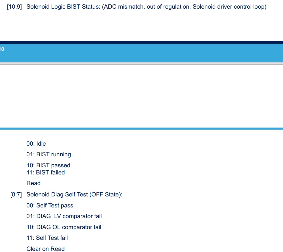

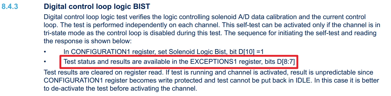

And I have another question: the status and results for BIST are in the EXCEPTION1 register D[8:7], is it correct? Shouldn't it be D[10:9]?

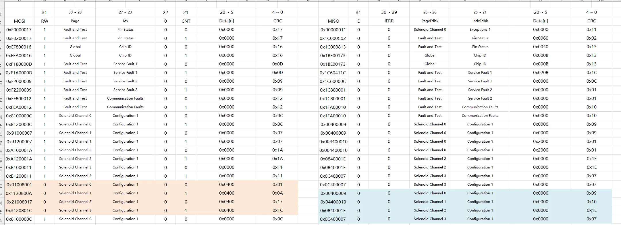

Hello ST expert:
I've encountered another problem: my SPI can only read, but writing fails. Why is that?
