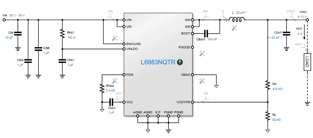

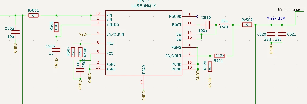

I have been trying to implement the L6983 in my design for about 4 month now and still don’t get the desired output. After checking the Fsw pin, it seems I don’t get any clock output, do you have any idea what would be the cause of this issue ? Here is m design.
The 0Ohm strips are only for a backup power supply.
The Fsw output is flat on GND at the oscilloscope.
The SW output before the inductor is at my supply voltage of 28V with small disconnects resulting in a flat 28V after the inductor.
The input is 28V and it should output 5.2V
The switching method should be 500kHz without dithering
Vs is delivered by a L6981 power supply + L39200 LDO at 3V3.
This issue is present on several iterations of this design even though we made sure to reference the ST eDesign Suite for our choices.

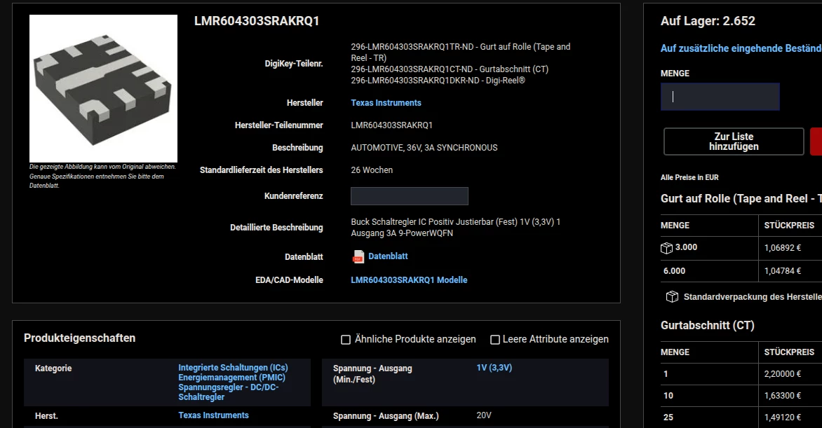

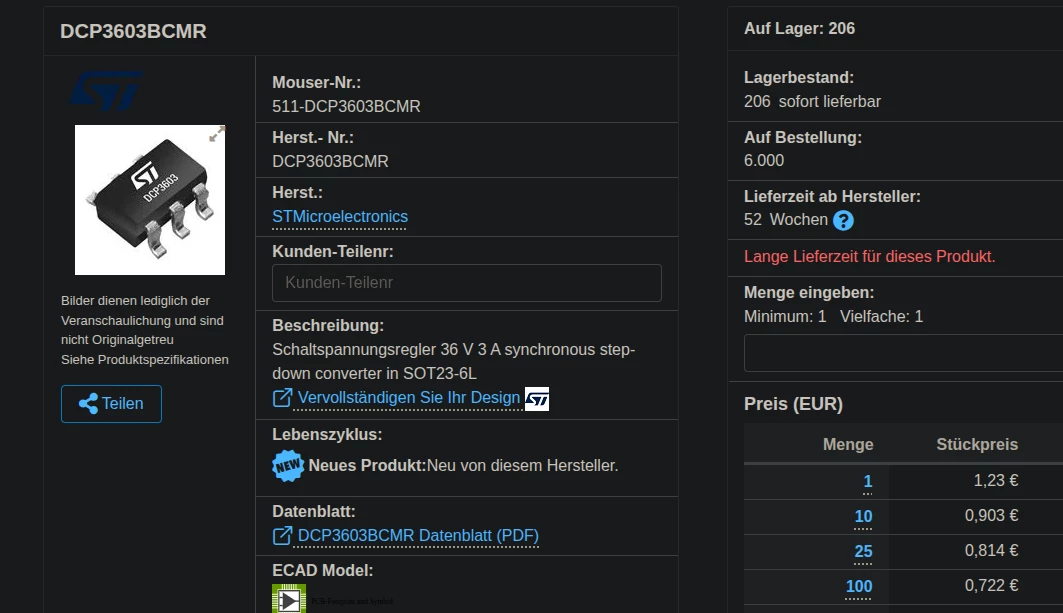

Try a new one :
DCP3603BCMR , 3A , 36V in max. , see:
or from Ti

As a European manufacturer, I am trying to limit my component choices to other European manufacturers which discards TI for most of my design choices unless the features are truly unique.

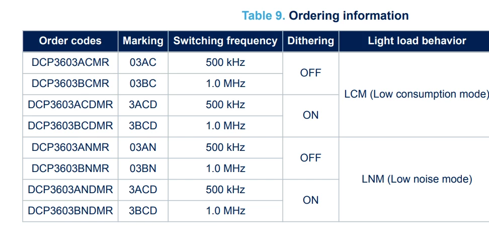

Also, this board is intended to go in an enclosed product that is very sensitive to its own EMI and dithering is not necessarily the best choice when you can filter them. So I wanted a product that would allow me to disable the dithering feature.
AScha.3
September 16, 2026
that's what i also prefer , so DCP3603BCMR or ..BNMR could be your choice.
I will try it next time - its new.
This is  a killer - an absolute no-go (for me) !
OUT = IN indicates the chip is dead, or shorted; the worst case , when using a buck regulator.
So i would never use this chip again or bother around with it. But … ymmv.

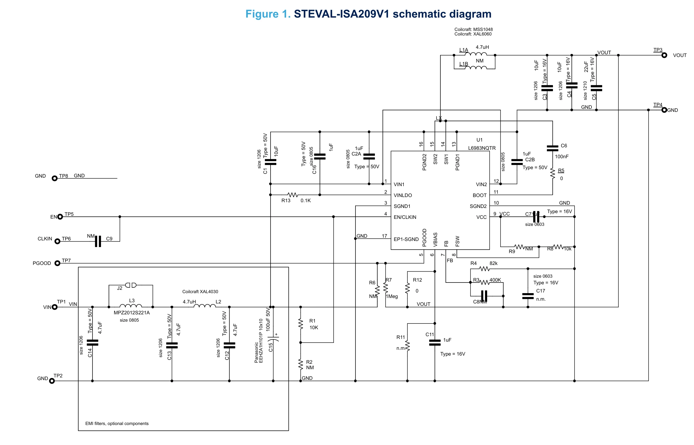

September 16, 2026
Please check the recommended schematics and Input, Output capacitor with inductor may need to be selected based on datasheet recommendation. Not sure your schematics is right or not...

After a first failed attempt, it was decided to heavily base the design on ST eDesign Suite. All the values you see on the schematic are the one used on the actual board.
September 17, 2026
Please check Iout Vout and Fsw value for the component selection, what is your Iout and Vout?
