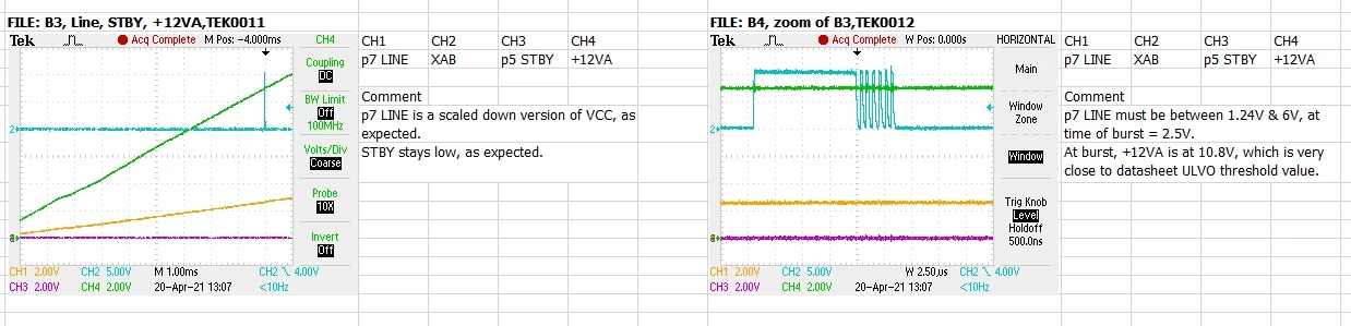

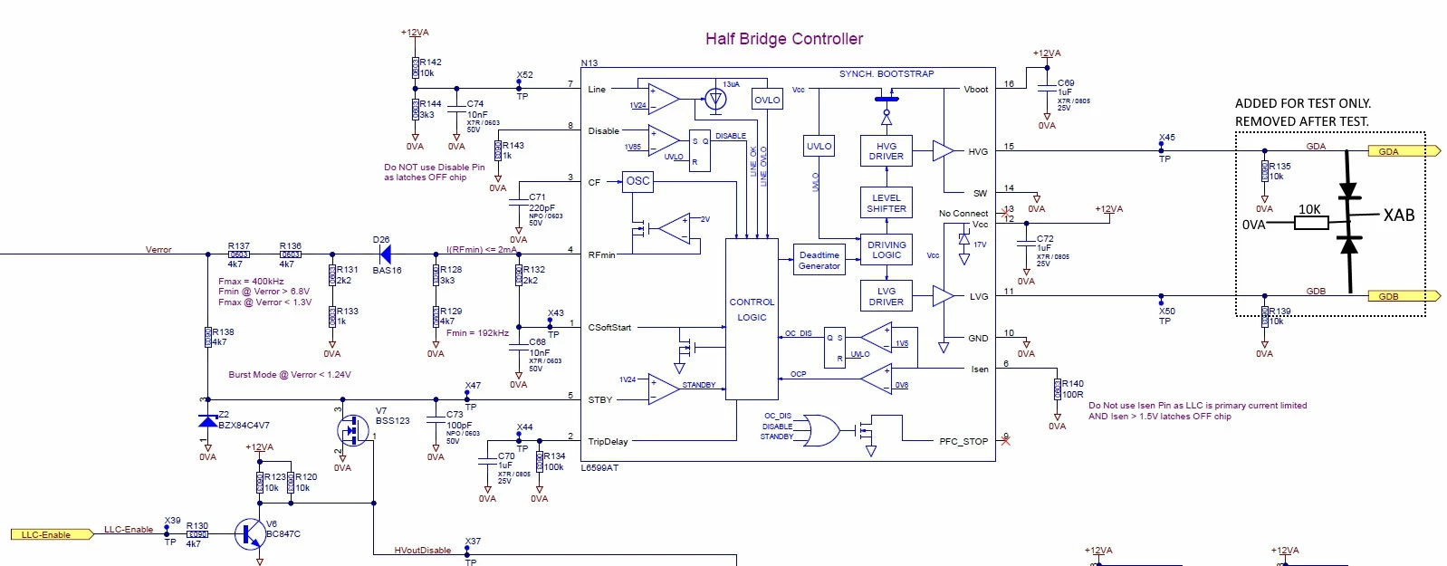

I have already checked the pins you mentioned with a scope, please refer to the 3rd paragraph of my original question. Also, from the schematic it is clear that some pins are not connected to any active device (eg: a logic gate, or transistor) that could cause a voltage, they are held in their de-asserted state (low) by pull-down resistors, specifically:
p6 Isen: 100r to 0V.
p2 TripDelay: 1uF & 100k to 0V.
p8 Disable: 1k to 0V.

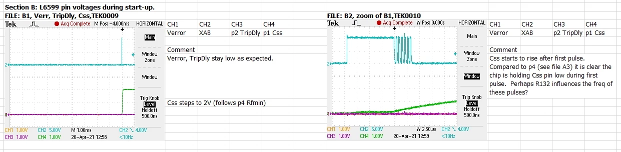

The only other signals to consider are pin 1 Css, and pin 5 STBY, let's examine each of these now.
Pin 1 Css: Refer the two images below, the one on the right is a zoom-in of the left image. Please refer to the comments within the image.
Pin 5 STBY: Refer the two images below, the one on the right is a zoom-in of the left image. Please refer to the comments within the image.
I trust that the above clearly proves that all pins of the L6599 are being kept at the correct state to stop the L6599 from activating its gate drivers during the ramp-up of the control power (+12V).
Do you agree?

Looking at the waveforms it is unclear why the IC starts operating, it is difficult to say the reason because it should not do that. To make hypothesis becomes difficult not having the board on workbench.
Anyway, coming to your Q2, the correct way to stop and start the IC properly is controlling the LINE pin. Therefore I suggest to connect the V7 Drain to LINE pin instead of STBY.
I also suggest:
  1. Decrease the R143 (DIS pin) to 100R for better noise immunity
  2. Increase C68 to slow down the soft start, a fast rising could generate some noise. Typically soft start have much longer time constant
  3. Increase C73 at least to 1nF
  4. If HVG/LVG are driving MOSFETs I wonder the PCB layout is made properly, the gate current is not mixed with control circuitry.
