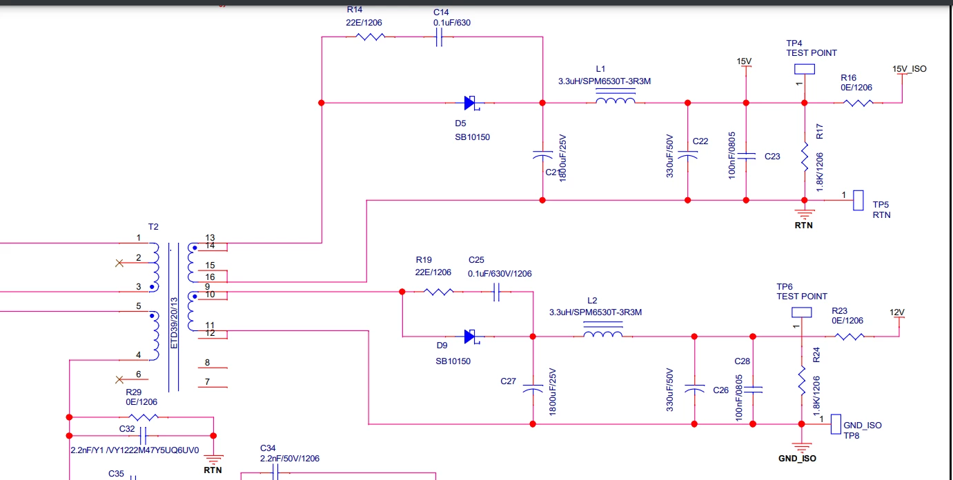

     i am designing flyback converter based on the l6566bh. i have 2 outputs on the secondary side, both are separate windings (different ground potential) in transformer. can i short together for shared ground reference if isolation is not necessary.

OK, in this case you can connect both GNDs together.
You can even reduce the costs even further by eliminating the second winding for 15V including D5, R14, C14 and C2, replacing L1 with an inductor with e.g. 1mH and connecting its left side (formerly at cathode D5) to 12V. L1, together with C23 and C22 (which you can make smaller or remove if necessary), forms a low-pass filter that further removes remaining ripple from the 12V rail.

Feb 11, 2025 5:06 AM UTC
 can i short RTN and GND_iso(transformer has separate winding for two outputs), both are isolated from primary side.secondary.png

Feb 11, 2025 7:24 AM UTC
Yes, the two secondary windings can have a common GND, so you can connect GND_ISO and RTN together.
However, 15V_ISO is then also galvanically (not directly) connected to 12V, so a current can flow from 15V-ISO to 12V if there is something in between.

Feb 11, 2025 7:46 AM UTC
Dear Sir,
The 15V and 12V rails have different ground potentials (in both the transformer windings and the PCB). Can I connect these two grounds externally using a jumper or wire? Will this cause voltage fluctuations?

Feb 11, 2025 8:14 AM UTC
You have not made any statement about what your connected loads look like. If there is a reason for the 15V and 12V rails to have different GND potentials, you can of course not simply connect the GND.
