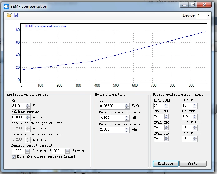

hi,guys,
how to calc ''Running target current''??
stepper motor parameter:1.5A current?nameplate?this is RMS current???
min speed:50 steps/s,max speed 2000 steps/s, ACC 1000 steps/s2,
test board:EVAL6470H && PCC009V2
But in the process of running:
Don't turn
Vibration noise is larger
What concessions motor run better?

parametrs seems ok.
I suggest setting the full-step speed value above the maximum speed (switching to full-step is required in very particular cases only) and adding a small mechanincal load to the motor shaft.
Please, check the IC is in HiZ state before writing the configuration.
