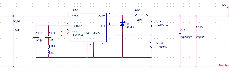

Hi
I'm trying to use L5973D for 24V in 12V Out
How can I calculate Max current when Vo is 12V
1 reply
Peter BENSCH
March 23, 2021
There are several factors influencing the max current in your design, e.g.:
  • current limit (for L5973D: min 2.5A)
  • power dissipation (max 2.25W according to the datasheet)
  • thermal resistance (for L5973D: 40K/W)
  • ambient temperature
  • possibly additional cooling
You should be able to get an output current of 2A, but maybe it is a good idea to simulate your design using our eDesignSuite.
