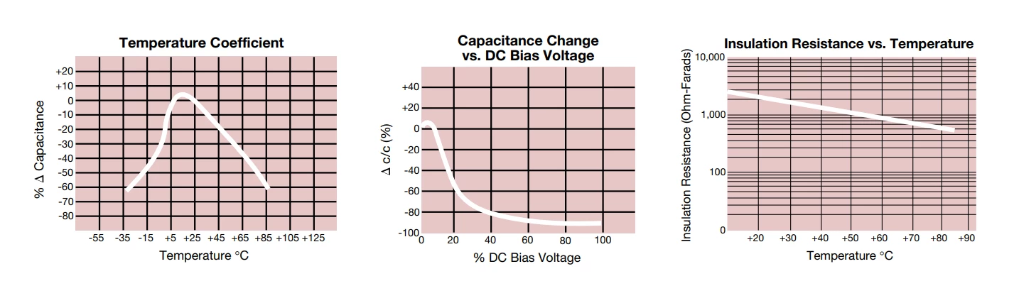

A design I am debugging is utilizing Y5V dielectric capacitors on the input and output of the L4931. There is a 2.2uF capacitor directly at the output and another 2.2uF capacitor on the other side of an ~4 Ohm resistor that analog supplies are used off of.

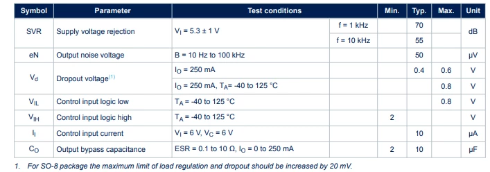

Are there any concerns over temperature for using this dielectric type with this LDO? I know that Y5V tends to have a pretty variable capacitance over the operating temperature range of this LDO. I wanted to check in and see if there is any margin on the LDO for the stability capacitor requirement that would accommodate this capacitor dielectric type.

That depends on the temperature range you have to cover. But Yes 2.2 uF Y5V is probably to low, the Datasheets gives 2 uF as minimal output capacitance:
You have to take in consideration not only the temperature but also the DC Bias Voltage!
