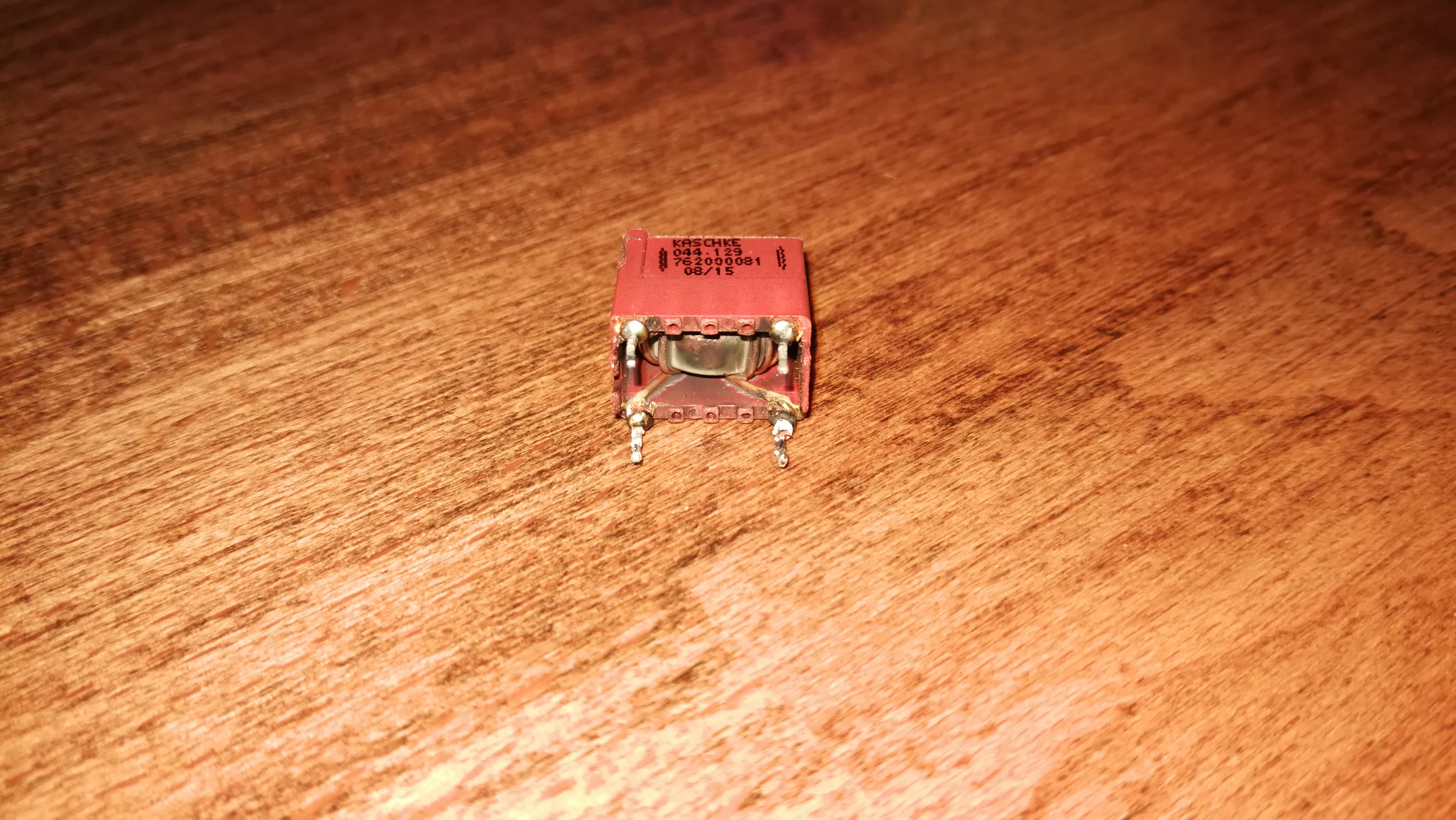

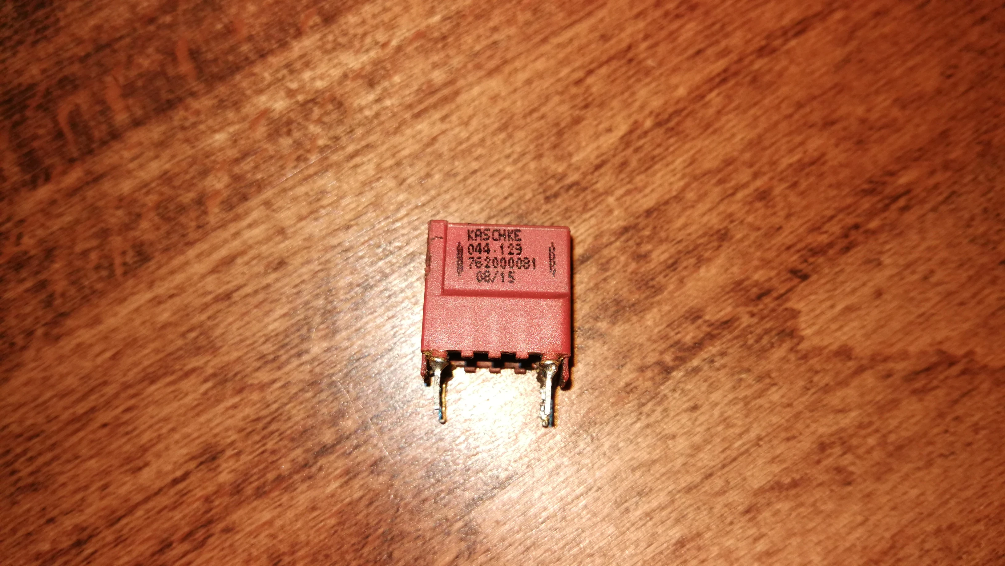

Hi everyone,
I have a power supply I'm trying to repair and have removed a Kaschke component that I'm unable to find a datasheet for.
Is anyone familiar with with manufacturer that can help me identify this component?
"KASCHKE 044.129"

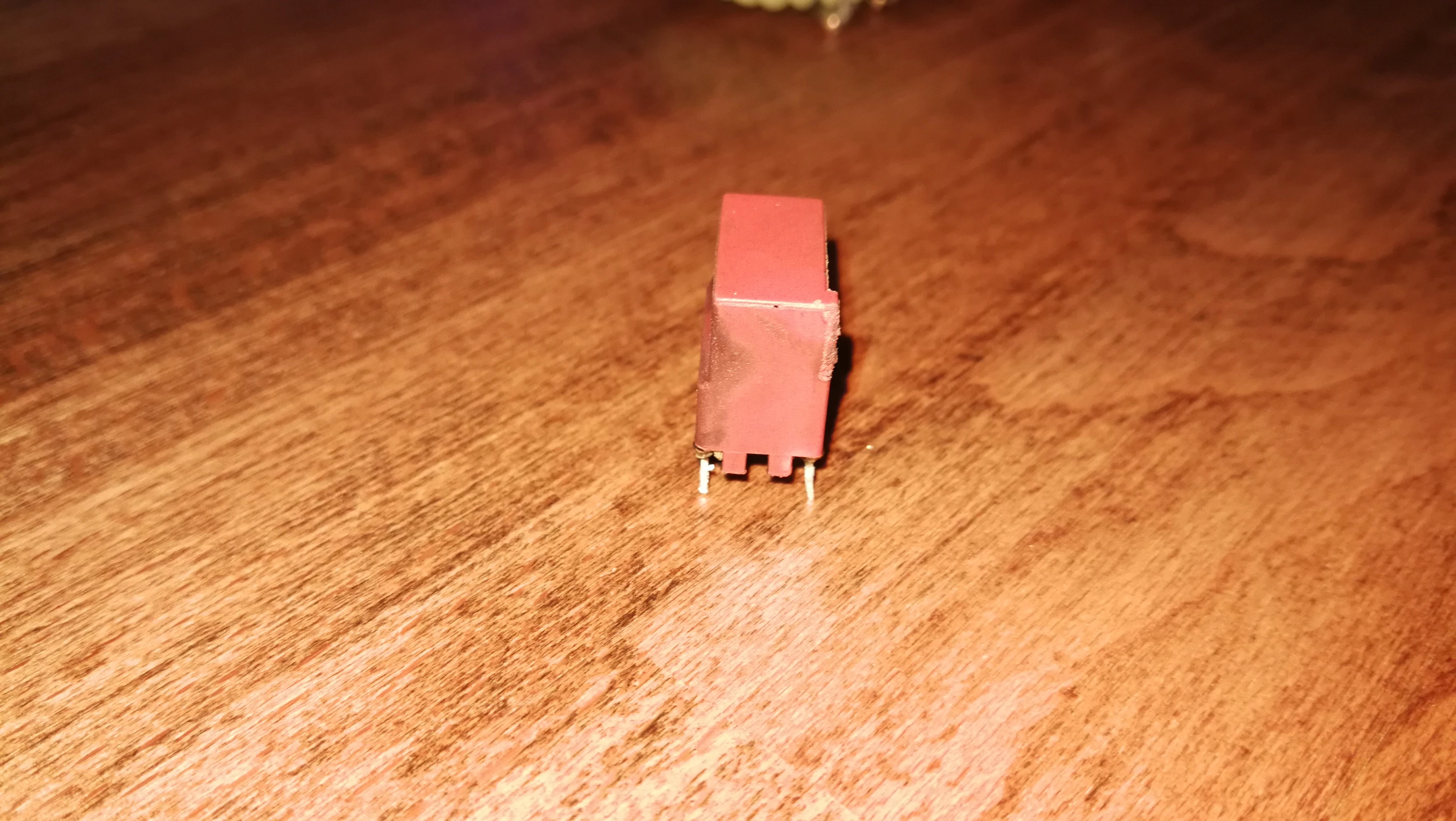

    I don't have some of the info with me that you've requested, but I have a few pictures that are hopefully helpful to you.
    I believe it is some type of inductor - it has 4 pins. I'm not sure what exactly it's purpose is in the circuit.
    The power supply is out of an automated light fixture (entertainment industry).

    Common Mode Toroid Choke, perhaps custom, you'd likely need to measure one not blown up.
    The off-the shelf ones have details, typically current/voltage
    Similar
    https://www.yoycart.com/Product/546971818050/
    https://www.kaschke.de/enquiries/
    https://www.solutions2business.com/wp-content/uploads/2017/06/Stromkomp.Ringdr._Flyer..pdf
    RDS 1517 TOROID CHOKE
    The Kormag guys might be more helpful
    https://www.kormag.co.uk/filters.html
    https://www.kormag.co.uk/products/pdf/FL_Stromkomp_RDS-KV3.pdf
