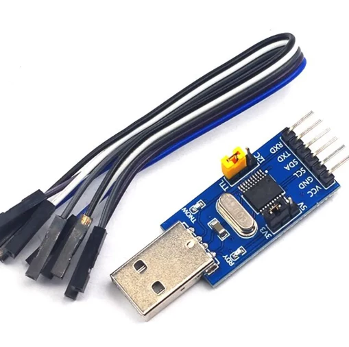

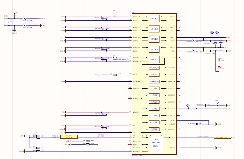

 I am using the power IC STPMIC1APGR to manage the power for my circuit board

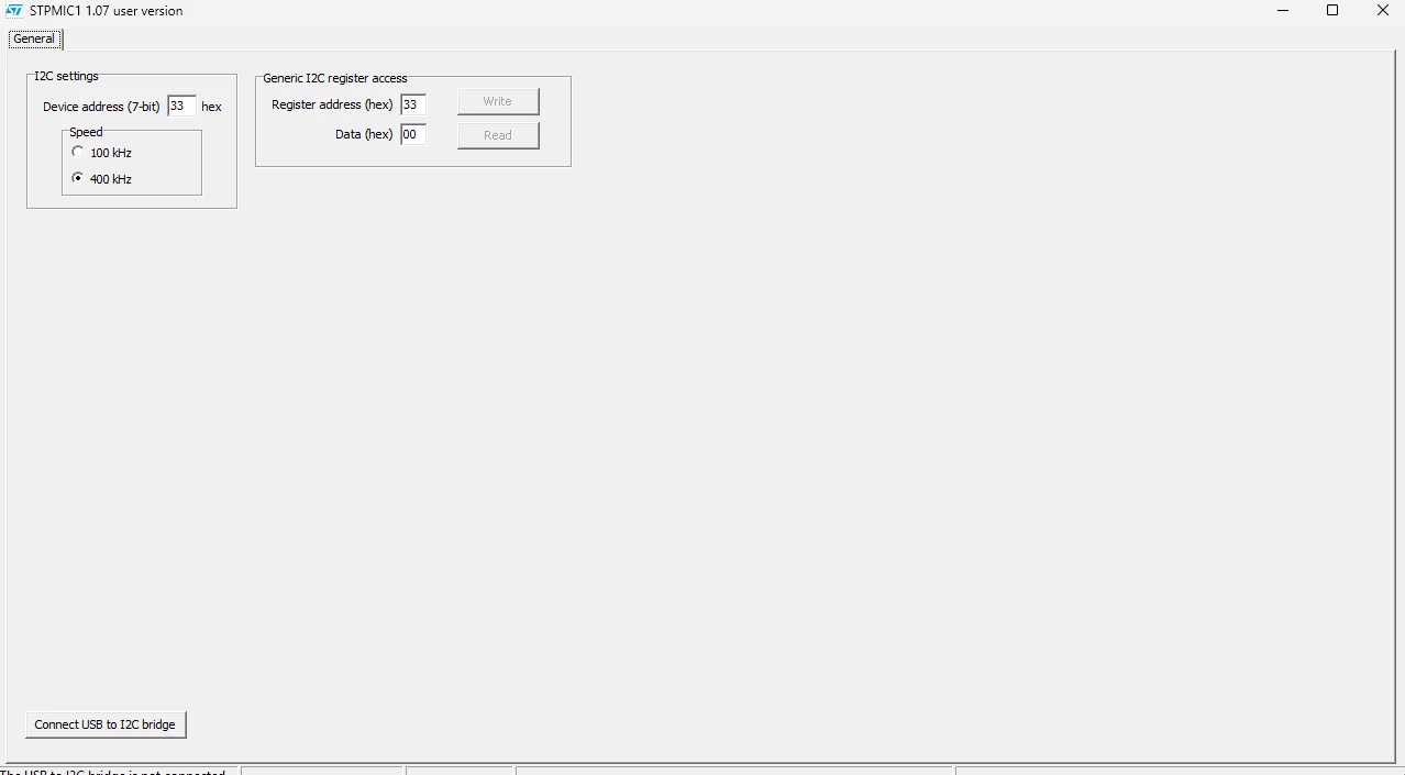

Currently I can't connect to STPMIC1 1.07 software (I use win 11 and USB to I2C converter CH341T_V3)my diagrammy diagramThe software is not connected yetThe software is not connected yetUSB to I2CUSB to I2C

    you cannot connect the GUI software with standard USB to I2C interface, your interface is working with a simple terminal software
    Regards
