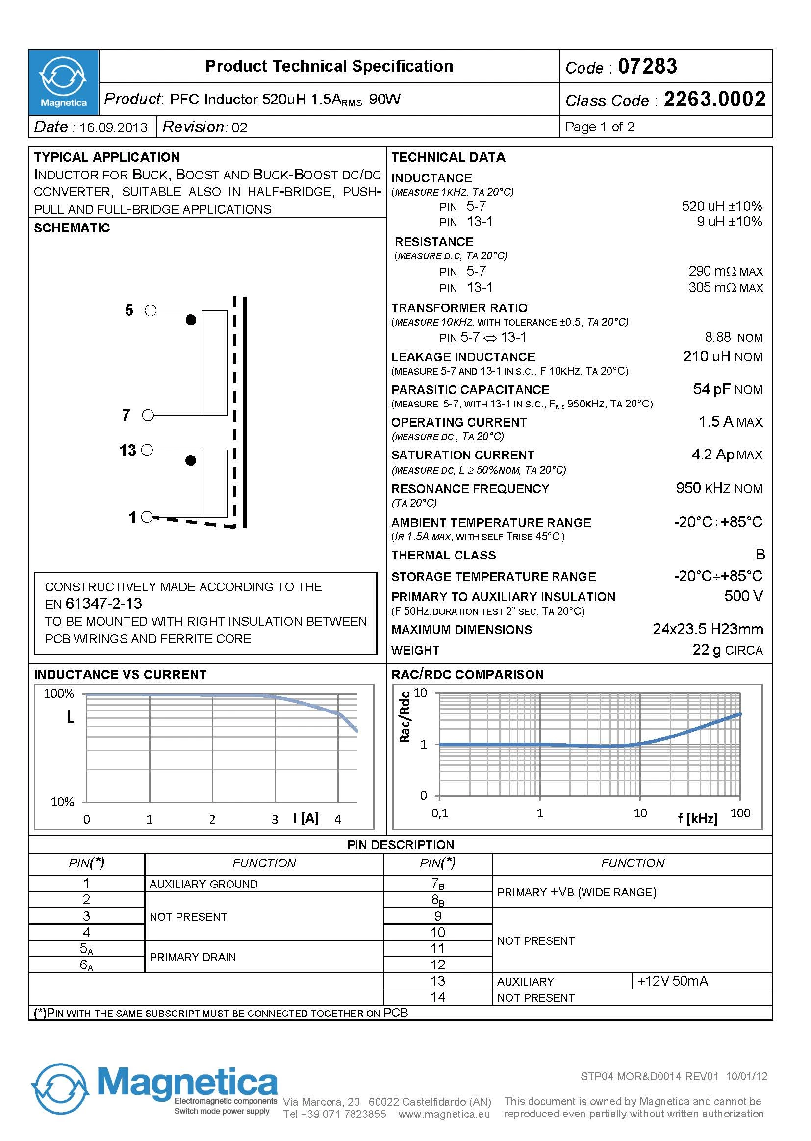

In the EVLCMB1-90WADP, what is L2 ?
  • February 17, 2017
  • 1 reply
  • 629 views
Posted on February 17, 2017 at 06:01
In the document EVLCMB1-90WADP, is L2 a simple inductor or a transformer? If it is a transformer, then what is the turns ratio?

Thanks to Magnetica!!!
