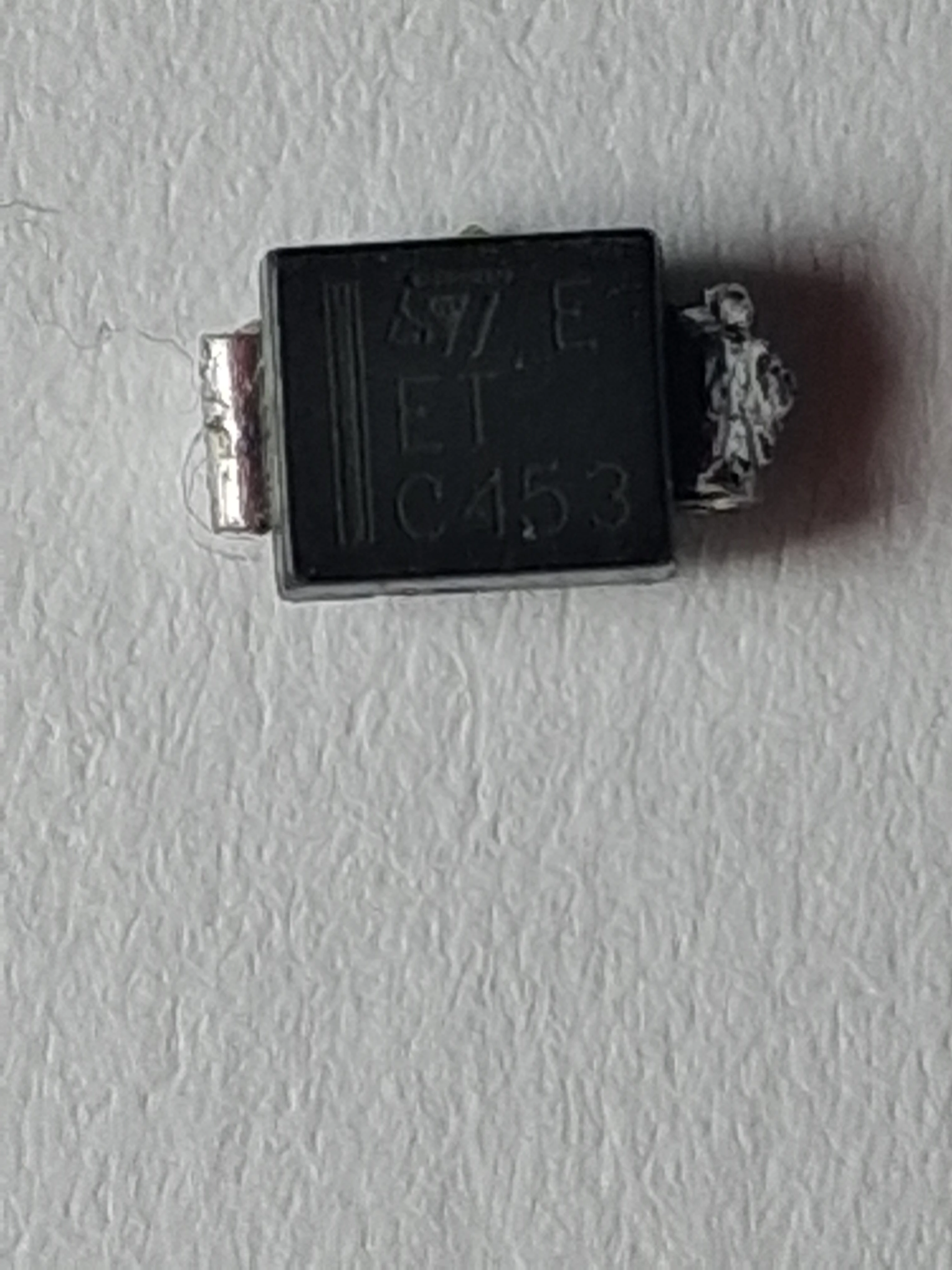

identify this diode ?
This account only shares restored community content posted by members between May 22 and June 9, 2026, who did not register for the new community.
Can anyone identify this diode and suggest an alternative please?
ST E
ET
C453

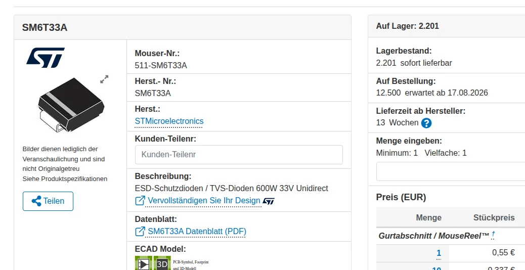

probably:
ET
SM6T33A
SGS-Thomson Microelectronics
DO-214AA
Transient voltage supressor
Vrwm=28.2V, Vbr=31.4..34.7V, 13.1A, 600W(1ms)

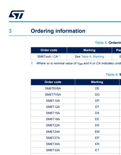

from ds:
ET  marking.
at mouser:

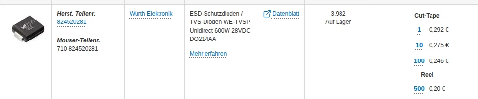

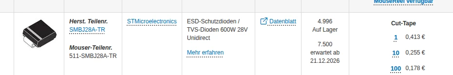

why alternative ?
similar 28V :
cheaper, more peak current: 100A
