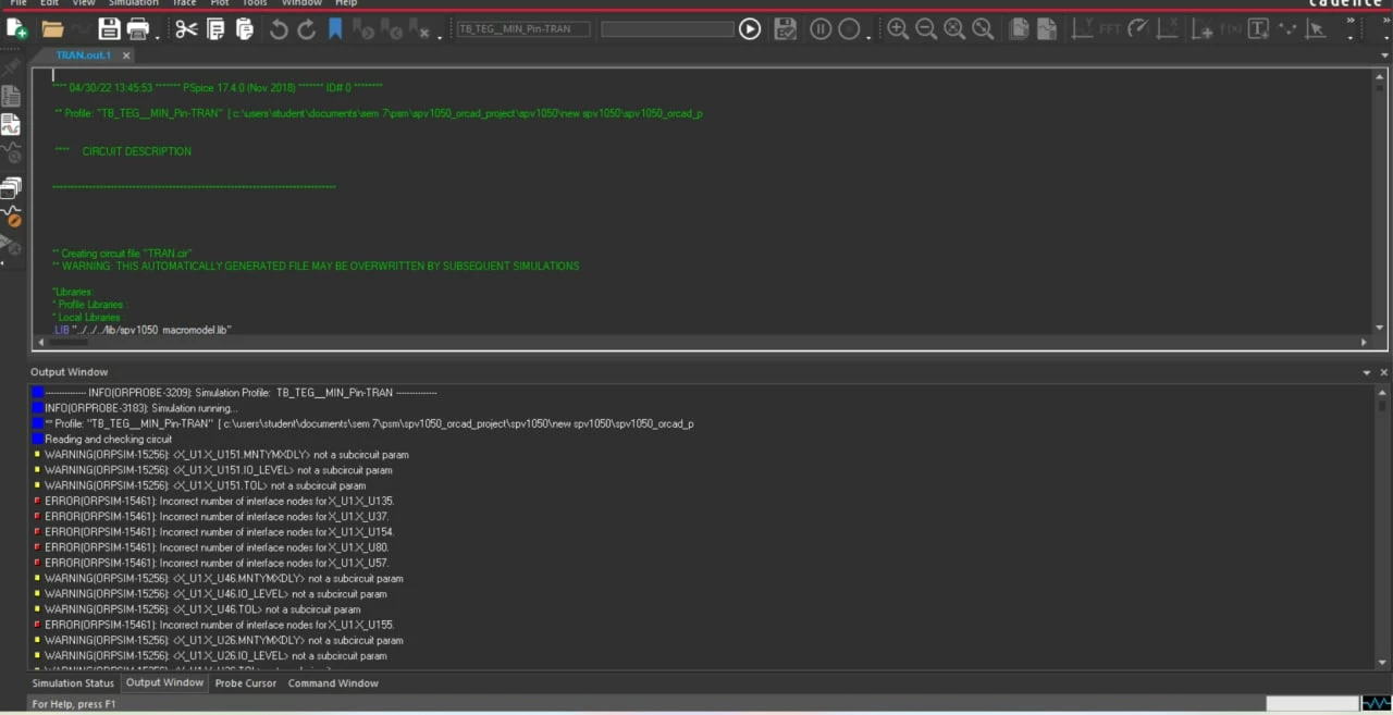

    0693W00000Nqc2LQAR.jpgI already get the file and do simulation using PSpice OrCAD cadence. but when I try to run the file that you gave me, the error comes out. it said ( shown in picture). did you know how to solve this error? and I realize something that the .lib file was encrypted. is it because the file was encrypted so the error come out??

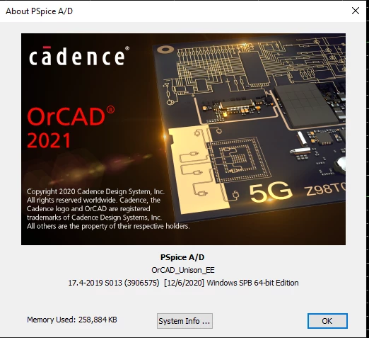

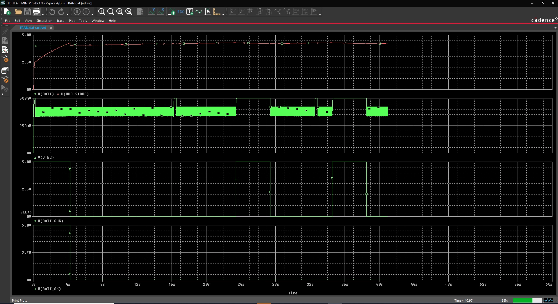

    @luckysquad​ ,
    The sent SPV1050_ORCAD_project works successfully in ST side, probably you are is using an old and not patched or not full features Cadence OrCAD PSpice v17.4 platform:
    below you find the ST obtained simulation results by running the user tried testbech TB_TEG_Min_Pin and the ST used OrCAD v17.4 platform ( it isn’t a demo version but a full licensed features) .
    Cadence OrCAD environment exhibits some issues managing projects stored in long Windows path therefore try also to store and start the SPV1050_ORCAD_project from a shorter path folder , for example from c:\temp.
    Regards

    luckysquad
    May 28, 2022
    can you explain a little bit about the picture that you have shown above and how the parameter set 500 m and 30 u influences the result that you get? i want to know, why you set parameter values like that and what the reasons.
