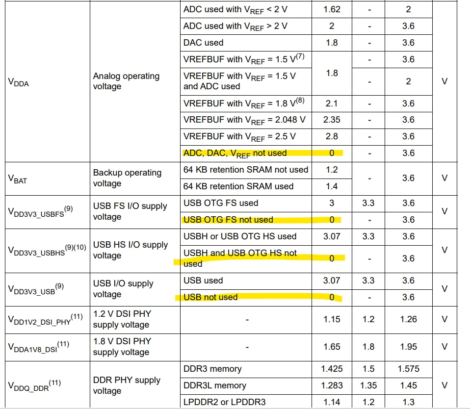

We're also exploring a power scheme consisting of discrete regulators. We notice that AN5256 "STM32MP151, STM32MP153 and STM32MP157 discrete power
supply hardware integration" provides good detail for such an approach. If we go this route, we would use a DDR3L power solution chip to provide VTT_DDR, VDD_DDR, and VREF_DDR. VDDCORE would be provided from a dedicated buck. VDD,VDD_ANA, VDD_PLL, VDD_DSI and other related would be star connected to another 3.3 buck. Since we don't intend to use ADC/DAC nor USB, can we simply not provide power to these domains? Looking at the datasheet, table 10 and table 13, it seems power pins related to ADC/DAC or USB can be set to 0 volts.

I think this question is followed in https://community.st.com/s/question/0D73W000001N0mo
