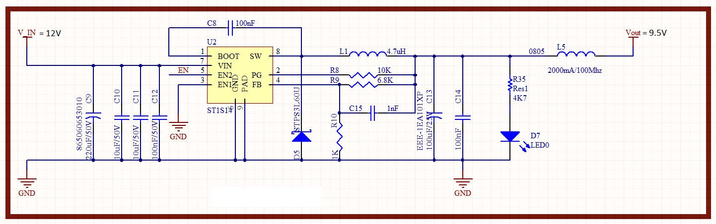

I have made a circuit using ST1S14 IC and i am unable to get the desired result. I want Iout to be atleast 1A. Can you help?

IMaka.1
Visitor II
February 19, 2020
