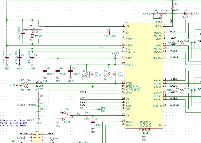

I have designed a development board for L6482. I did solder C1, C2, C3, C4, C5, C6, C7, C8 and D1, then supply 24VDC to test the power scheme of L6482 but VCC is still 0V. Should it be 7.5V after supply 24VDC according to my attached schematic?

Peter BENSCH
Mar 31, 2023 5:27 PM UTC
Welcome, @huytung1501​, to the community!
Correct, if the 24V are present at VS and can also be measured at VSREG, and all GND connections are also connected, a voltage of 7.5V should be measurable at VCC and VCCREG in your circuit.
Please also try to measure the current that is drawn via 24V.

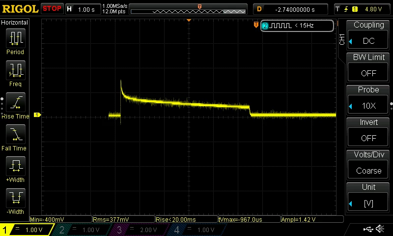

huytung1501
Apr 1, 2023 4:43 AM UTC
0693W00000bhKNTQA2.pngThis is the waveform of VCC during start-up
Peter BENSCH
Apr 2, 2023 6:50 PM UTC
I suspect a problem with the layout, possibly also one with the component.
Do you have a chance to use an EVAL6482H-DISC as a known working board for comparison?

huytung1501
huytung1501AuthorBest answer
Apr 26, 2023 4:17 PM UTC
@Peter BENSCH​
I found the problem. It's not the layout nor the component.
RESET pin: If not used, it should be connected to VREG [Datasheet page 17]
This is not correct, at least in my case.
External control signal is required to drive RESET line to high level so that the internal regulators can work properly.
