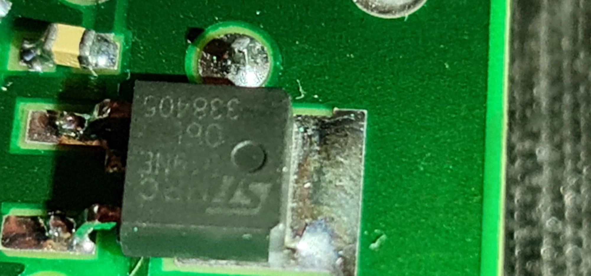

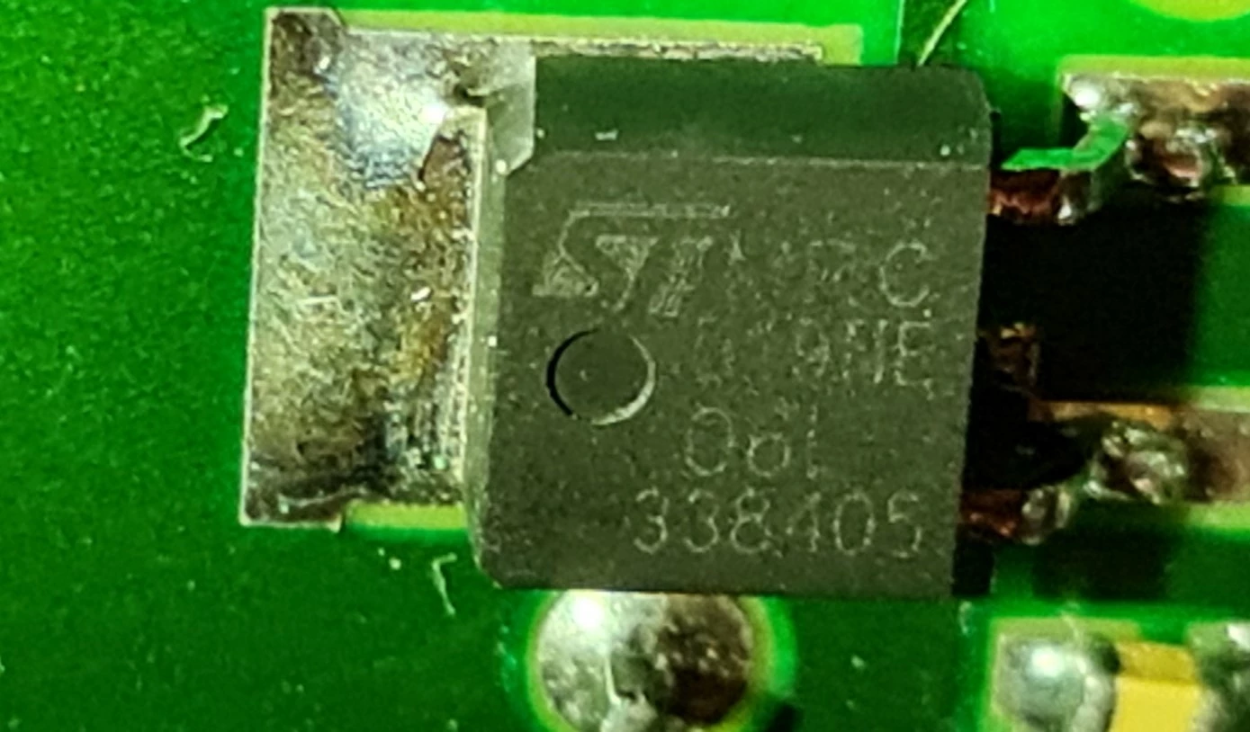

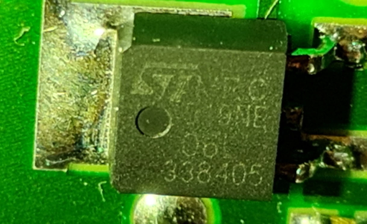

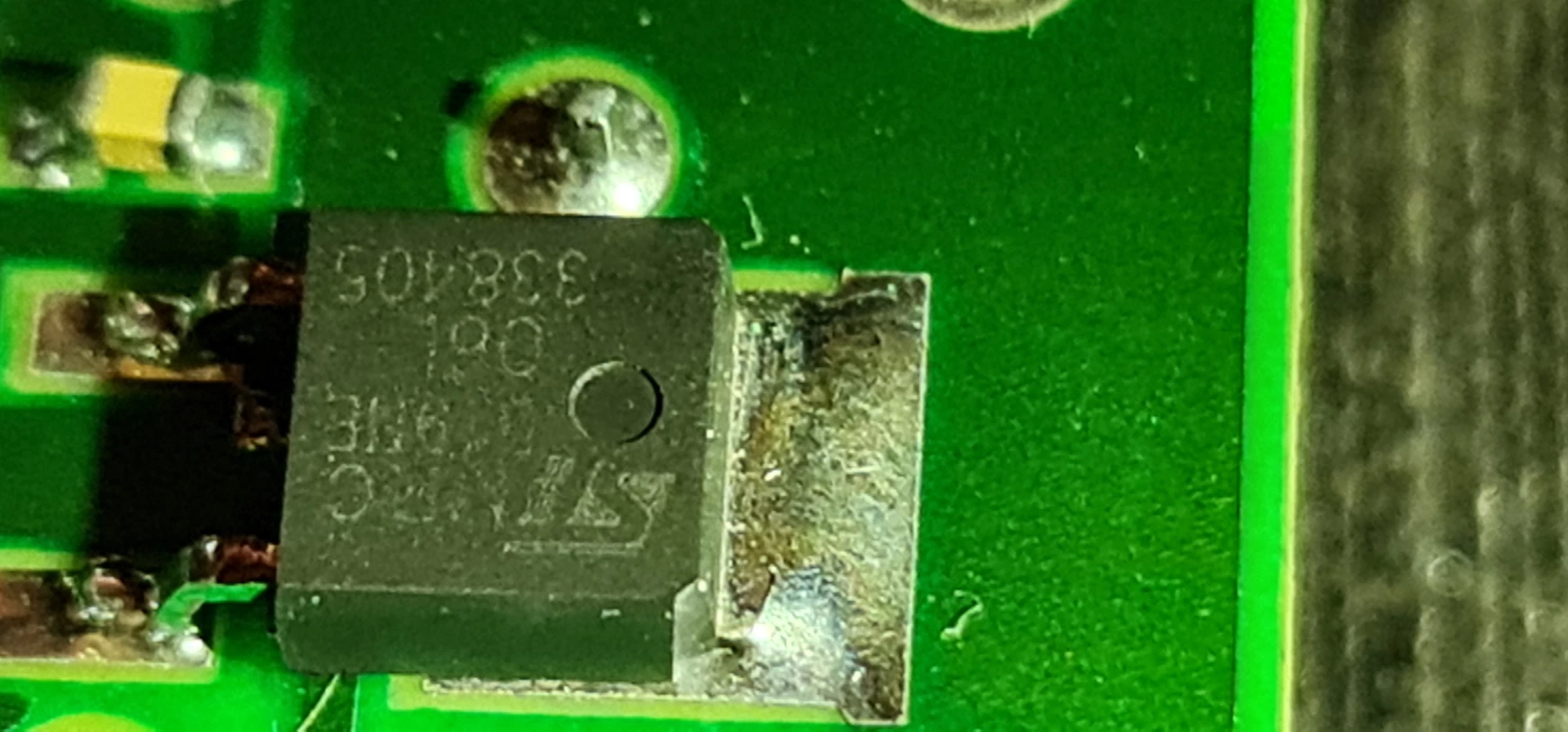

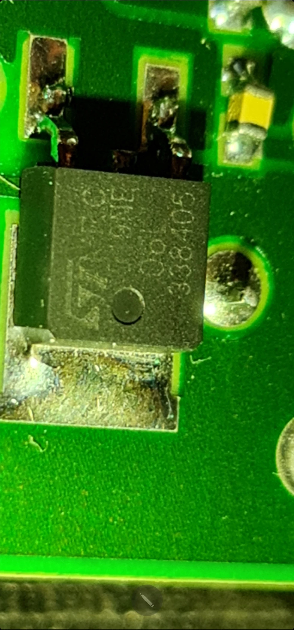

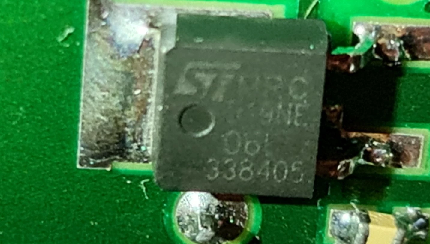

I can't find a special component to repair a device. Can anyone help me. See details and photos below. Thanks in advance.
Here are pictures of the component I'm looking for.
This comes from a control board for a rear light (Led) from an Aston Martin DB9 - 2005.
There are 4 on the board and one of them is burnt.
I can not find this component in the trade and impossible to find an equivalent.
0693W00000FDtV0QAL.jpg0693W00000FDtUbQAL.jpg0693W00000FDtU7QAL.jpg0693W00000FDtTdQAL.jpg

    It was the STP19NE06L, an n-ch FET in DPAK, 60V, 24A, 40mohms (max), 13nC, meanwhile obsolete:
    https://www.st.com/en/power-transistors/std19nf06l.html
    You might consider the STD25N10F7 as a replacement:
    https://www.st.com/en/power-transistors/std25n10f7.html
    Good luck!

    Uwe Bonnes
    Chief
    Oct 27, 2021 10:27 AM UTC

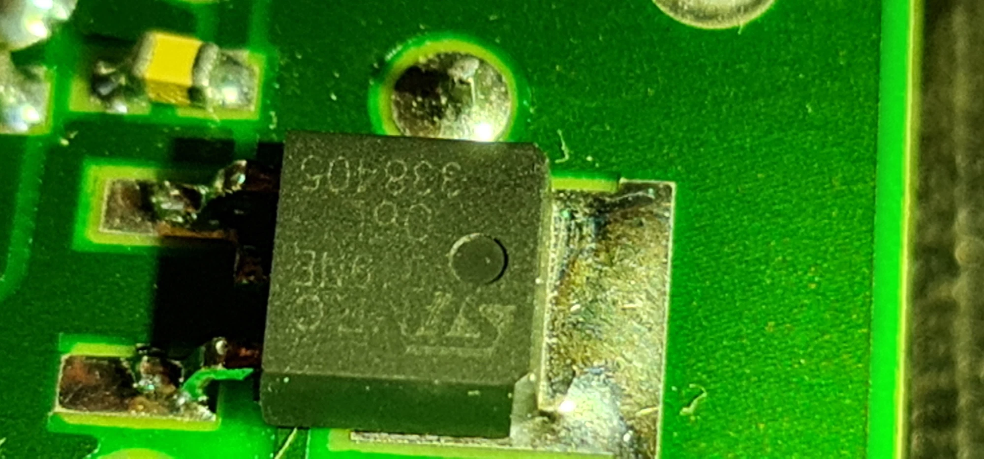

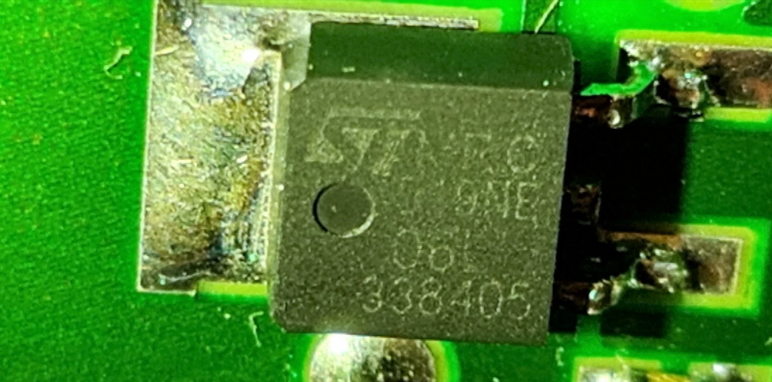

    Rotating the pictures could help somehow. Writing down what you decipher would help more.
    DBENS.1
    DBENS.1Author
    Oct 27, 2021 12:27 PM UTC
    Thank you for your answer.
    I can read only part of the reference :
    MFC or NFC or MRC or NRC
    19NE 06L 338405
    0693W00000FDupQQAT.jpg0693W00000FDupBQAT.jpg0693W00000FDuohQAD.jpg0693W00000FDuoIQAT.jpg
    Uwe Bonnes
    Chief
    Oct 27, 2021 1:10 PM UTC
    the picture at https://www.ebay.com/itm/224227338361 match partial.
    Peter BENSCH
    Peter BENSCHBest answer
    Oct 29, 2021 7:59 PM UTC
    Good luck!
    Regards
    /Peter
    DBENS.1
    DBENS.1Author
    Oct 30, 2021 7:27 AM UTC
    Hi Peter,
    thank you very much for your answer.
    Your informations are very complete and they will be very useful to me.
    I will immediately order the component.
    Best regards
